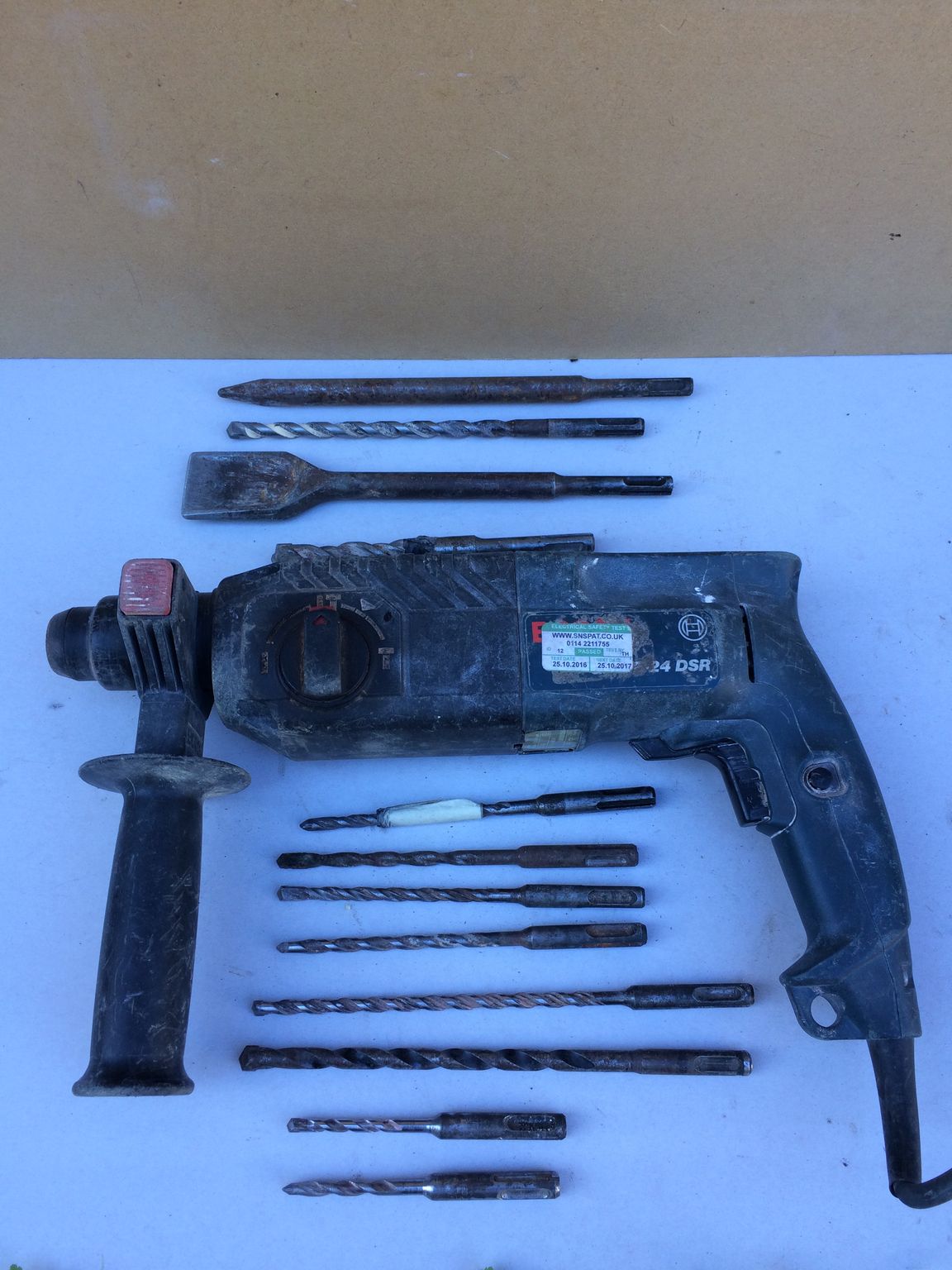

Did anyone mention an SDS drill?
I have a Makita cordless and Bosch green corded drill, both hammer, both could barely scratch the old solid bricks in my house. Bought one of these beasties - goes through it like butter!
