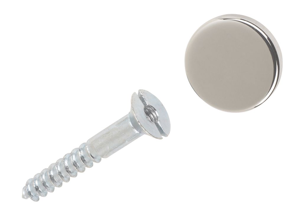

and...if you want a nice finish with the screws, use mirrors screws with screw in cover plates.
[img] http://s7g3.scene7.com/is/image/ae235?$p$&layer=0&size=281,281&layer=1&size=281,281&src=ae235/33912_P [/img]
http://www.screwfix.com/p/mirror-screws-8ga-x-1-polished-chrome-pack-of-10/33912

And +1 for Stoner's screw cap advice...he does come up with the odd useful bit occasionally. 🙂
