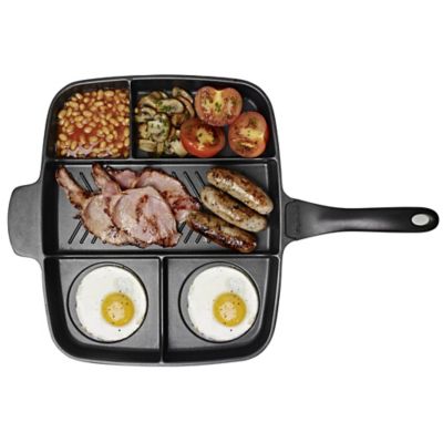

Rectangular hob? Rectangular pan!
[img] http://lakelandcamel.scene7.com/is/image/LakelandCamel/71133_1?$800$ [/img]
