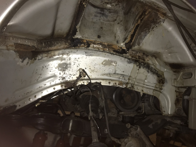

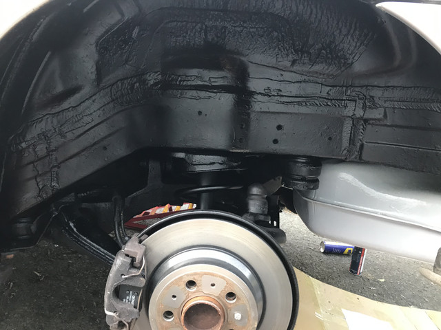

Posts: 6709
My method is to remove as much rust as possible with mechanical means (grinder with 3M strip-it discs, or Dremel and mini flap wheels for smaller intricate areas).
Apply Fertan rust converter to 'kill' any corrosion that has pitted into the steel.
Follow that with Jotun Mastic 87winter grade epoxy.
Remove any arch liners and prepare for mission creep.
[url= https://i.ibb.co/q9n2XWY/IMG-8024.jp g" target="_blank">https://i.ibb.co/q9n2XWY/IMG-8024.jp g"/> [/img][/url]
[url= https://i.ibb.co/SsQPvVz/IMG-9701.jp g" target="_blank">https://i.ibb.co/SsQPvVz/IMG-9701.jp g"/> [/img][/url]
Posted : 11/03/2024 3:36 pm
