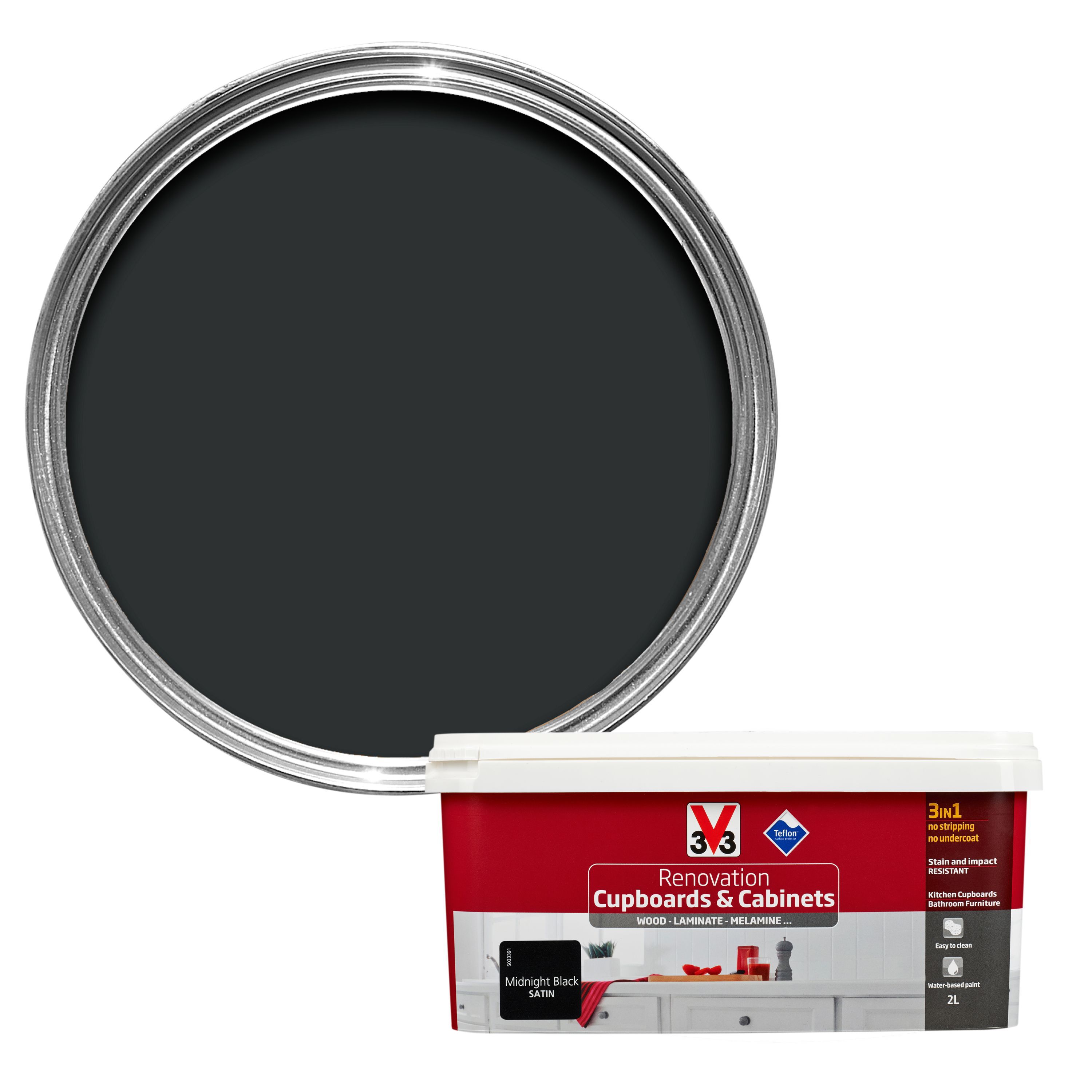

I have just finished painting mine (well maybe two weeks ago). The Laminate on some of the doors was peeling off, looking old at tatty so it was time to go. You can get the finish as good as you want to be honest. I started the first couple of doors meticulously back sanding and being very careful to get it looking perfect, then I realised it was all a vast improvement over the old laminate so just battered on.
Very happy with the results. Will try to find the paint for you.
Edit: Used V33 cupboards and cabinets renovation paint.
