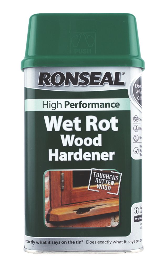

Must only be stud partition walls it's under? If so the plaster would have sucked up water and be showing damp. Find the extent of rot and then cut it out. Or, if it's hidden under the bath, just sort the leak and treat the rot? As you say, floorboards aren't structural. You can get some paint on rot stop stuff that does a pretty good job - meant for window frames.
[img] http://s7g3.scene7.com/is/image/ae235?$p$&layer=0&size=281,281&layer=1&size=281,281&src=ae235/63540_P [/img]
