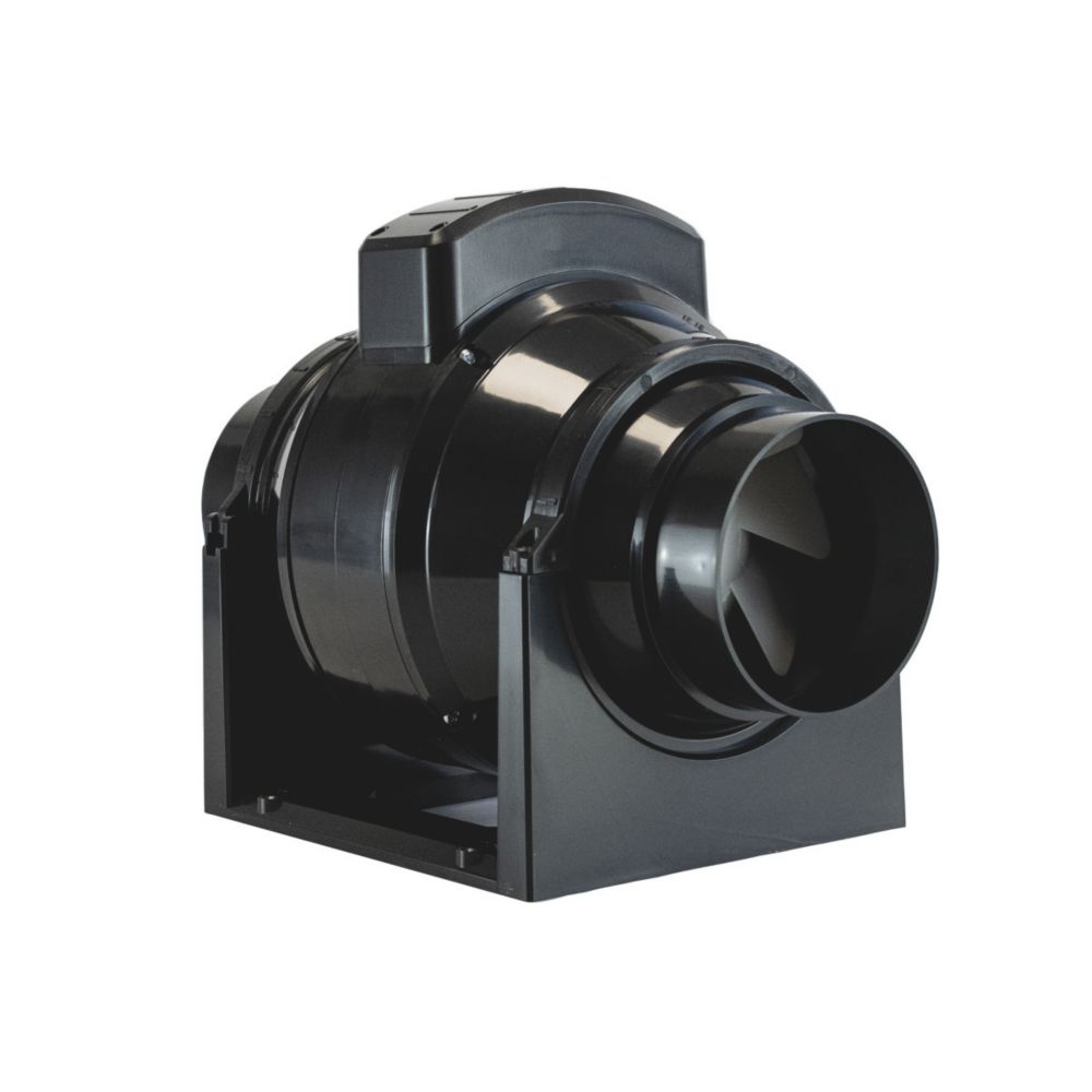

In the bathroom I'm surprised no-one has mentioned one of these mounted in the loft, the good ol' MF100T:

I've just replaced a useless ceiling fan with the Manrose MF100T and it's superb. Combined with some new aluminium ducting the difference is substantial.
I just read through the posts to see if anyone had – we have two of these monsters (en-suite and main bathroom) and they are great. My wife has *very* long showers in the en-suite and it clears the steam away almost as quickly as it is created – the mirror will be free from condensation within a couple of minutes of the shower being switched off and the fully tiled room is almost dry. It has been fitted for three years, we both shower daily and there is absolutely no sign of mould starting.
Please note though – look for one like the one posted above and [b]not the one below[/b] - it is the replacement version and isn't meant to be as reliable or effective.
[img] http://s7g3.scene7.com/is/image//ae235?src=ae235/26867_P&$prodImageMedium$ [/img]
[url= https://www.amazon.co.uk/MF100T-EXTRACTOR-MIXEDFLOW-VENTILATION-HYDROPONICS/dp/B01G8DM5UA ]Original still appears to be available[/url]
