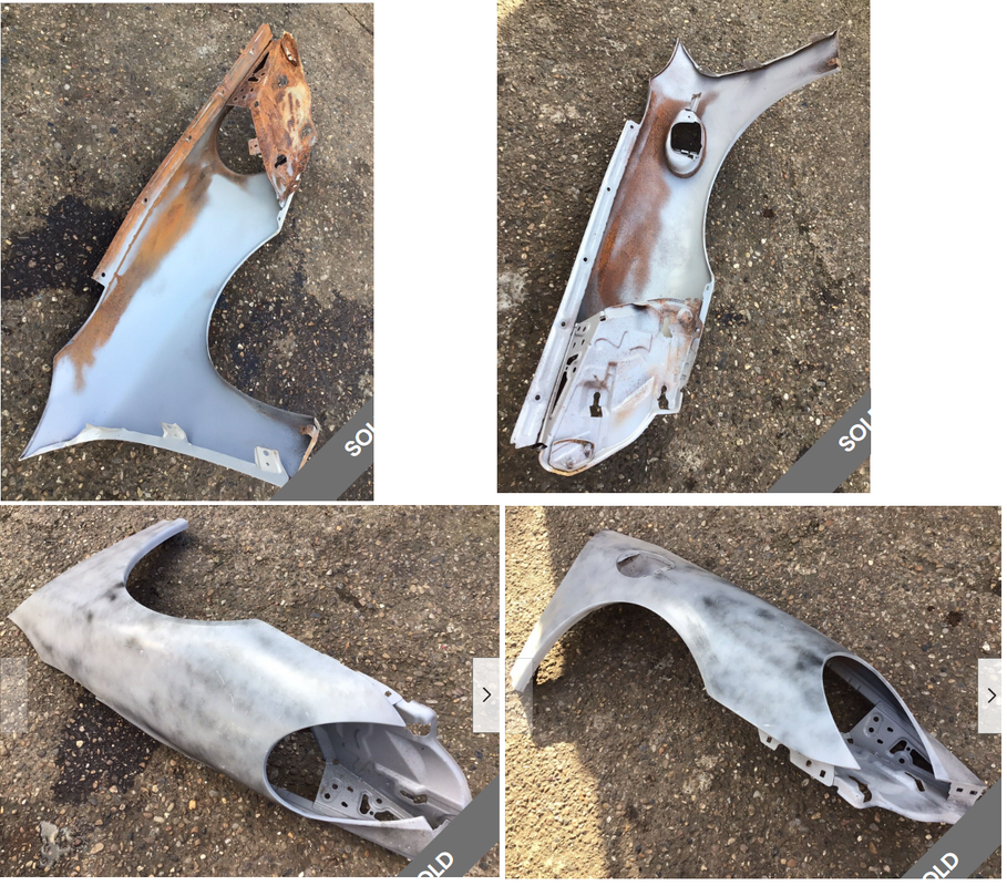

It gets a bit closer to the next episode. I have just hit buiy on these and now need to get them sent down from Derby.
[url= https://i.postimg.cc/6qB1dkfS/Scrap-Front-Wings.pn g" target="_blank">https://i.postimg.cc/6qB1dkfS/Scrap-Front-Wings.pn g"/> [/img][/url]

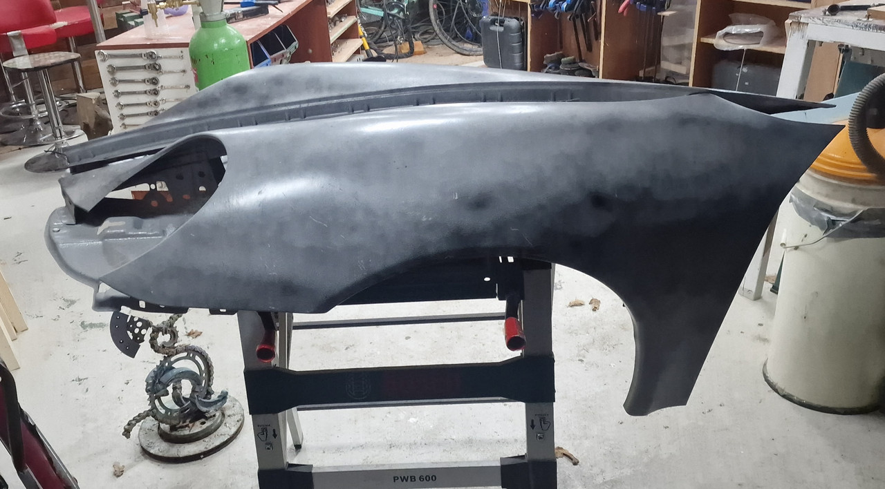

Posts: 13676
Well they have arrived.
[url= https://i.postimg.cc/mgFZQ6PV/First-Sight.jp g" target="_blank">https://i.postimg.cc/mgFZQ6PV/First-Sight.jp g"/> [/img][/url]
Now I just need to cut some off, add some foam and shape it to look like this.
[url= https://i.postimg.cc/28rXdq3t/Citroen-Left.jp g" target="_blank">https://i.postimg.cc/28rXdq3t/Citroen-Left.jp g"/> [/img][/url]
And try to work out how to make the headlight pod of course. Next video should come as soon as I get a chance to make some progress but I am a bit busy with art commissions, work and Christmas preparations so like and subscribe to get an notification when it arrives.
This is the original idea : https://youtu.be/PlGSR6w2_hI
Posted : 07/12/2023 10:18 pm

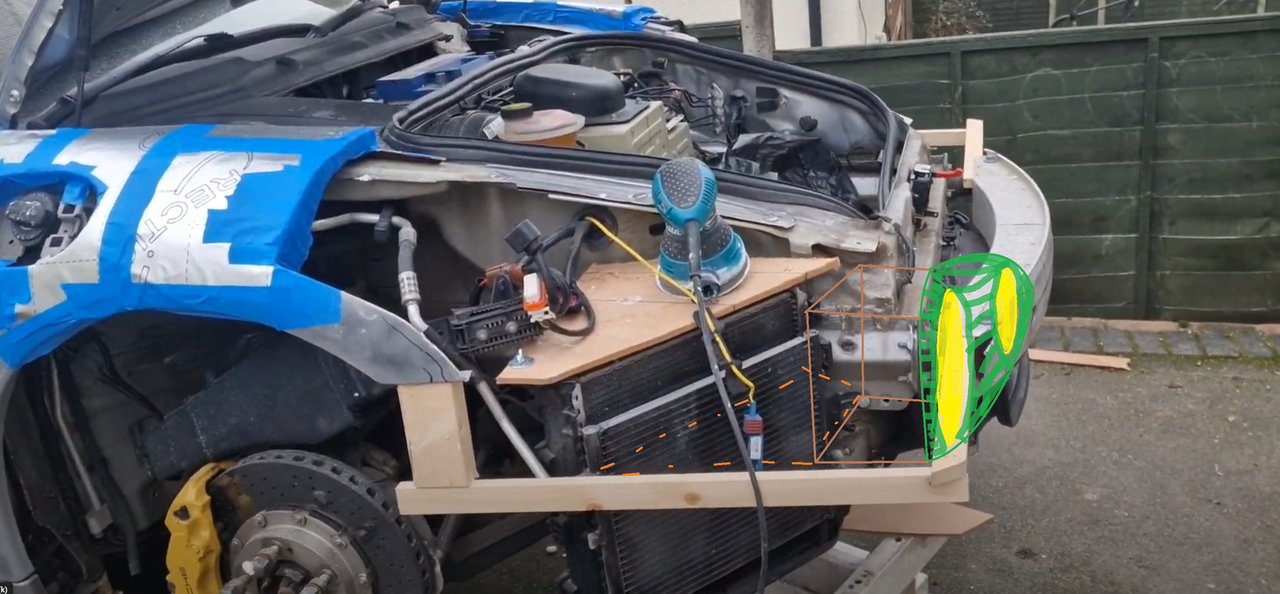

You would be really amazed at how much work has gone into this project between the end of Part 4 video.
and then current situation which is this.
Basically I realised that the MDF and doam buck I made in Part 3 needed to have the headlights made in Part 4 integrated and to do that I needed to know where on the car EXACTLY the headlights would go. This meant stripping the car down, which I originally wanted to avoid, and scrapping the whole idea of a moulding plug on the frame in the garage.
So I stripped the car and started to fit the scrap wings from the garage buck but needed various brackets to do this. I could have easily knocked these up in CF or glass fibre apart from the fact the temperature was hovering around zero. I used a few sheets of MDF instead as a temporary solution. This worked fine until we got hit by the storm which ripped the car cover open and soaked the MDF which simply collapsed, ruining everything I had done up to that point.
I am not sure what out of the hours of video I will actually use for the next episode as most of it is now irrelevant. Anyway, we have headlights mounted in the approximate moulds resting in approximately correct position.
I need to make a secure mounting platform to be able to bolts them in place.
I need to sort out some resistors to let the LEDs work without triggering CAN Bus errors,
I need to cut a new wiring from the original Porsche (proprietary?) connector to split to two new H4 LED connectors with indicators and DLR (possibly not fitted to my car) as required.
I need to build another pair of frames to hold the foam to shape the wings.
I need to replace all the wooden brackets with CF once it warms
I need to make a CF copy of the original bonnet so I can make a new bonnet without ruining my good one.

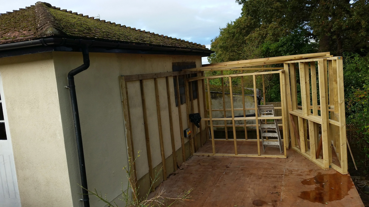

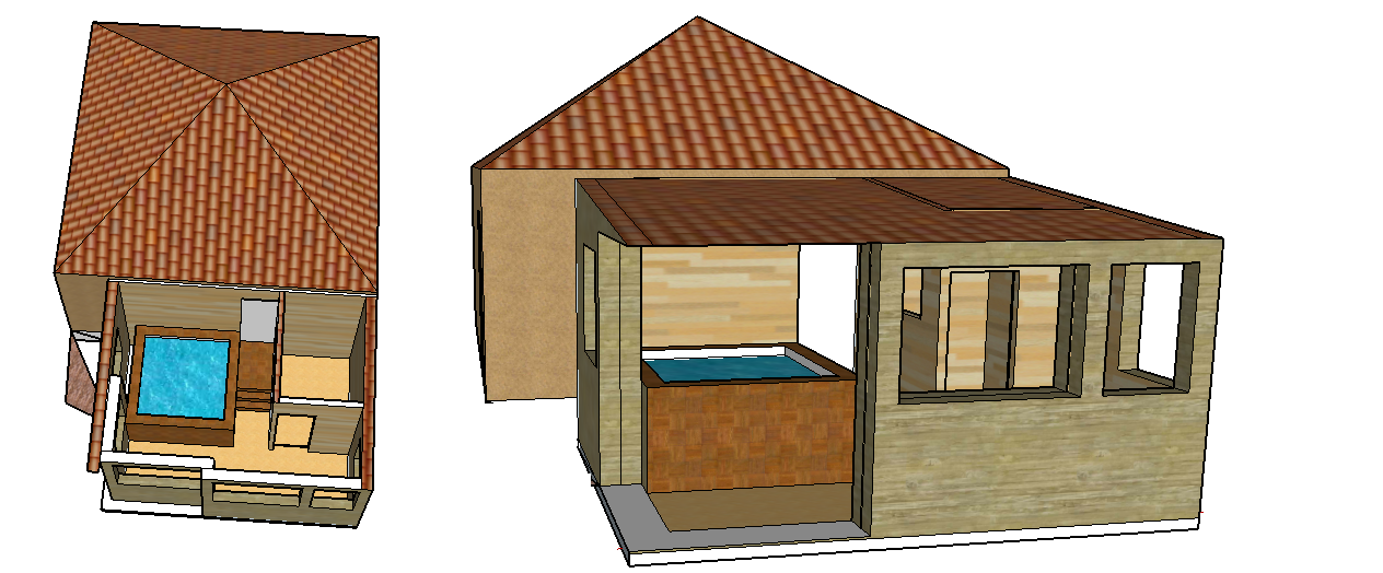

The sauna and hot tub is something I knocked up myself to help me medically. I knackered my ankle so struggle with walking and end up with tight and twisted muscles. Sitting in the tub and then the sauna most evenings relieves the tension allowing me to continue to arse about the next day.
[url= https://i.postimg.cc/tJNHnqvL/Sauna-Design.pn g" target="_blank">https://i.postimg.cc/tJNHnqvL/Sauna-Design.pn g"/> [/img][/url]
[url= https://i.postimg.cc/kG6fLfKw/Sauna-Build.pn g" target="_blank">https://i.postimg.cc/kG6fLfKw/Sauna-Build.pn g"/> [/img][/url]
[url= https://i.postimg.cc/pXSsYbN7/sauna.jp g" target="_blank">https://i.postimg.cc/pXSsYbN7/sauna.jp g"/> [/img][/url]
There is no way I could afford to get one built and installed by someone else.
