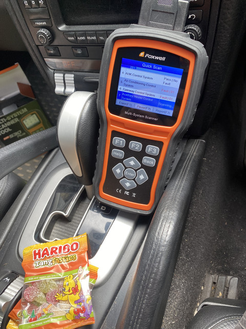

Just bought a £165 Foxwell 530 for my Cayenne as the service light was annoying me. Will code modules and other Porsche specific stuff.
[url= https://i.ibb.co/phZcQtj/IMG-8576.jp g" target="_blank">https://i.ibb.co/phZcQtj/IMG-8576.jp g"/> [/img][/url]
