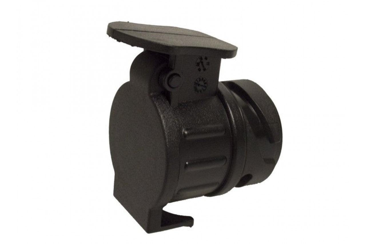

It sounds like you both need something like this 13 to 7 pin adaptor
https://towsure.com/products/towbar-electrics-adaptor-13-to-7-pin-adaptor?_pos=2&_sid=ab4b2252c&_ss=r
They are available both ways and much less hassle than trying to rewire the plug.
I've got a 13 pin Euro socket on my Mitsubishi and use one of these on an old 7 pin number board occasionally and it works perfectly.

Posts: 381
I got an adaptor but it makes it too long and then fouls with bracketry on the towbar.
