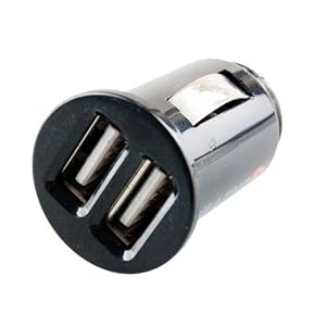

geoff, could you please post a link for the multi adaptor in the picture you posted?
thanks
Posted : 23/07/2012 11:53 am
thanks, geoff 🙂
Posted : 23/07/2012 12:08 pm
