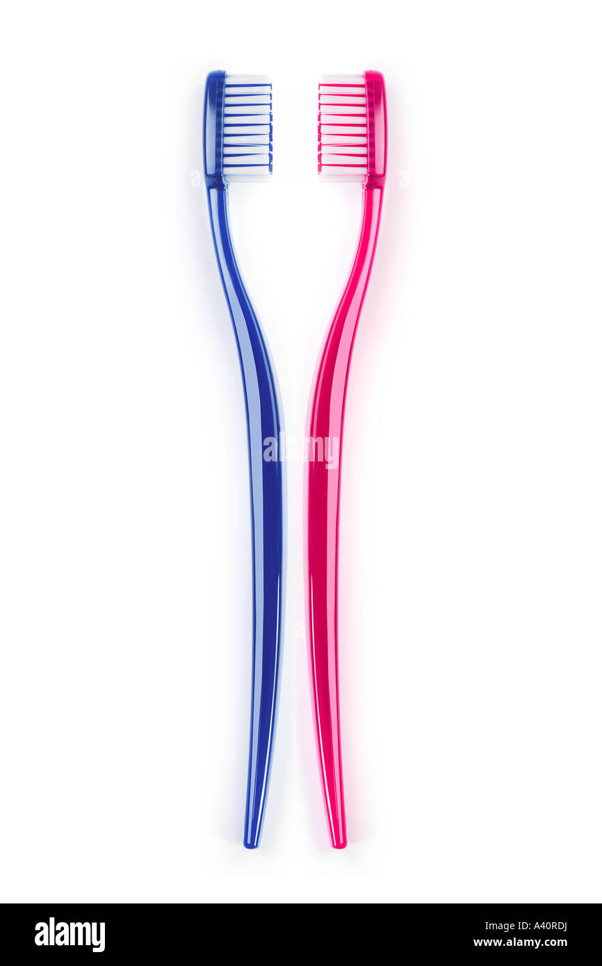

I got through several chain-cleaning devices, which are pricey, faffy and tend to break. I'm currently using 2 toothbrushes, zip-tied together with the heads facing one another. This seems to work, is effectively free, and is almost indestructible.
it's when it's moving the damage is caused so as soon as you hit that first gritty puddle the wear begins
This is true. However, you [i]can[/i] (try to) make sure that there is lubricant rather than grit in the moving parts before you hit the first puddle. Indeed, on some rides you don't hit a gritty puddle at all. And if the chain is pretty clean when you start, it's easier to get one day's grit off at a time.

Chain goes in the middle 🙂
