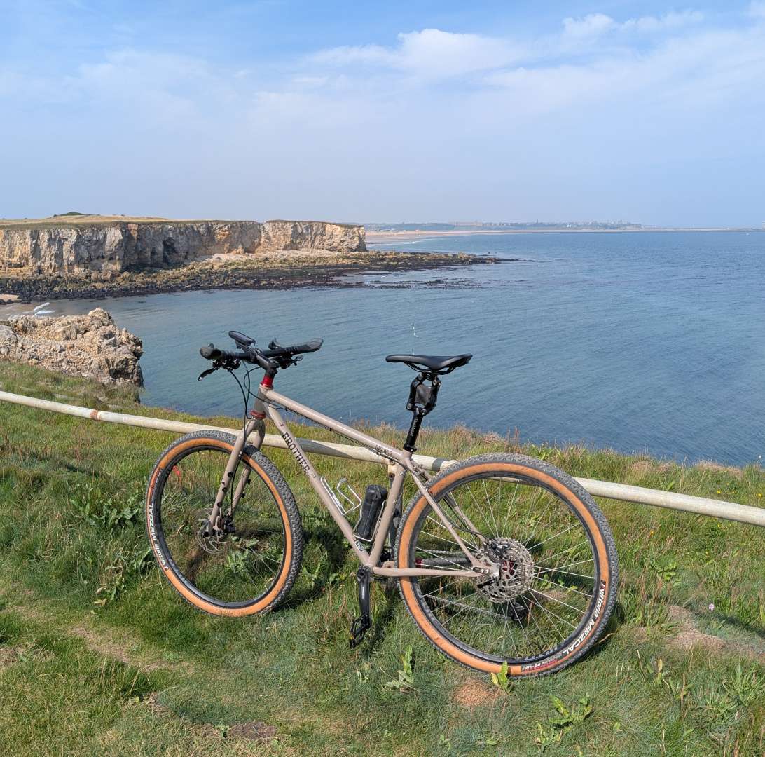

Posts: 1021
Thanks for that. Although I'm on the stockier side I'm not a hard rider, but considering some luggage carrying next year, I might consider the 34 instead
This is my Big Bro
Thanks again
