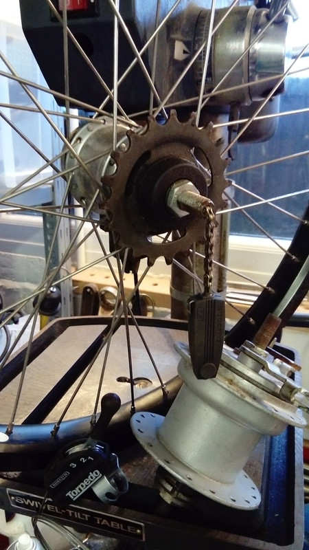

Posts: 3676
My commuter Alfine does seem to tolerate neglect... But I'm probably storing up trouble as the early ones had a reputation for getting written off due to bearing race corrosion.
[url= https://i.postimg.cc/zBgXfj6w/DSC-0730.jp g" target="_blank">https://i.postimg.cc/zBgXfj6w/DSC-0730.jp g"/> [/img][/url]
And some Sachs treasure to excite the OP
[url= https://i.postimg.cc/KjCPMJ8Z/DSC-0732.jp g" target="_blank">https://i.postimg.cc/KjCPMJ8Z/DSC-0732.jp g"/> [/img][/url]
Posted : 23/02/2020 8:20 pm
