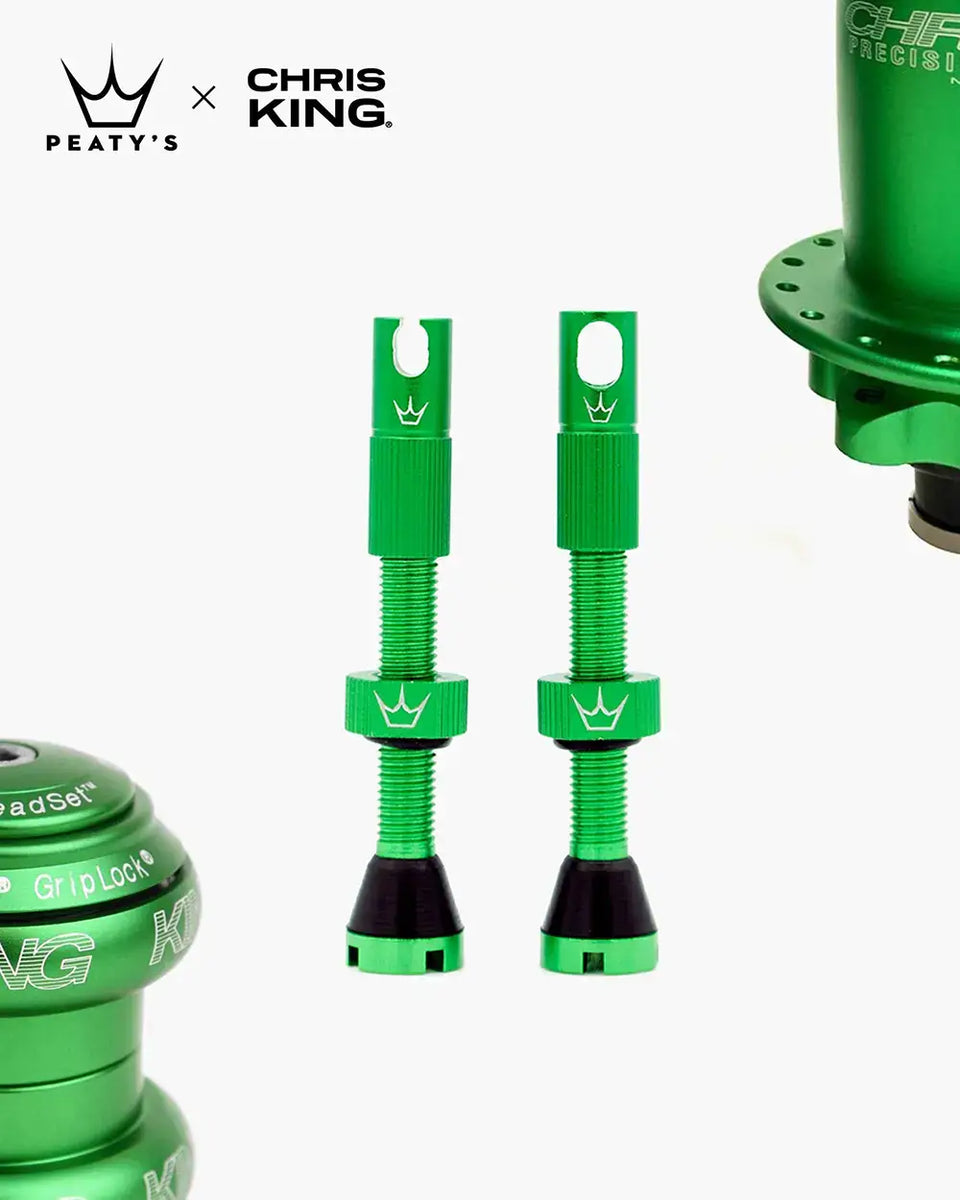

sorry just saw this - yep didnt work for me - even with my big old joe blow mountain track pump i couldnt get the air in, it just rebounded the air back through the pump
looking at those valves they do have a escape for air on the side too, so not much different than the rimpact ones?
either way didnt work - now making me more reluctant to even buy the rimpact ones and just not bother

https://peatys.co.uk/collections/tubeless-valves/products/peatys-x-chris-king-mk2-tubeless-valves
Peaty's valves worked fine for me with rimpact pro..
Posted : 01/09/2022 10:44 am

Had the air release issue with my first set, but that was because the bike shop had used that god awful Peaty’s sealant. Was so thick and claggy, the air only came out in small amounts. Pushed the valves through like you had to, cleaned everything out and replaced with Stan’s and no issues since. Liked them that much I added them to the ebike using Stan’s from the start and they’ve been perfect.
For Peaty’s valves, I think they only recommend the MK2 version.
