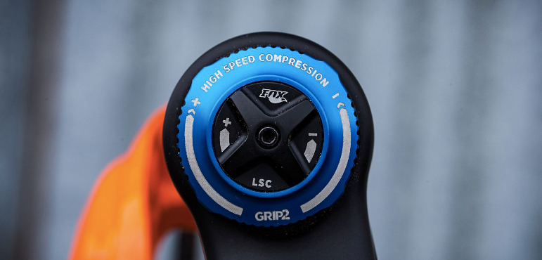

The Grip2 damper is not a sealed damper, it’s more like a open oil bath with an IFP, with oil bleeding off above the IFP into the lower leg and refilling the damper from the lowers oil.
Whether mixing the oils will effect the damping is another matter.

The 5wt Teflon-infused isn't just bath oil - it's also the oil used in the Grip2 damper and there's a mechanism in that that dumps excess oil into the lowers/sucks up additional oil.
The 5wt in the damper side and the 20wt Gold in the air side have always been the oils for the 36 Grip2 (or at least that's what it has been since 2018).
I wouldn't use non-5wt TI in the damper side. Actually - I wouldn't use non-20wt Gold, either.

Fox Grip2 damper:
https://cyclinic.com.au/blogs/suspension/fox-36-fit-grip-2-updates-into-2019
"The IFP system is a good thing is due to it's dampening consistency and reliability. It allows the damper to perform much like the RC2 FIT damper, but when the damper is getting 'worked' with either long hard 'shuttle runs' and general heavy use, it can self-regulate its damper pressure by 'spitting' excess fluid from the damper, back into the lowers for re-circulation. It does this via a spring-loaded piston (the IFP) towards the top of the damper that seals fluids from escaping in normal riding conditions. Under heavy riding conditions / heavy use, the piston moves upwards towards the top of the damper as the oil pressure and volume increases. At a point in which the spring-loaded IFP moves up along the inner damper shaft, it meets a 'scalloped' out section of inner shaft (see pic below) that allows the excess oil to flow past. A small bleed hole in the high-pressure outer chamber tube then allows this fluid back into the lower leg 'bath'."
