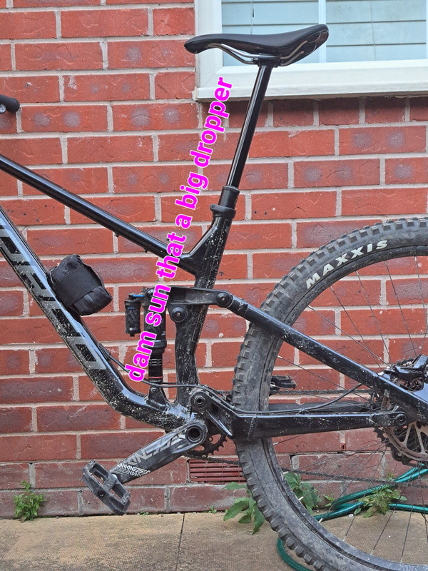

Posts: 9249
Right, I didn't want to sleep on it so I've gone for the OneUp V2. The PNW also looks like a fine choice but nothing can match the 240mm drop. That will make a huge difference to my comfort on the bike.
It seems to be unanimously well reviewed and easy to service at home so there shouldn't be too many problems.
I was scared of getting a lemon but it looks like there's a lot less crap out there since I first bought one over 10 years ago.

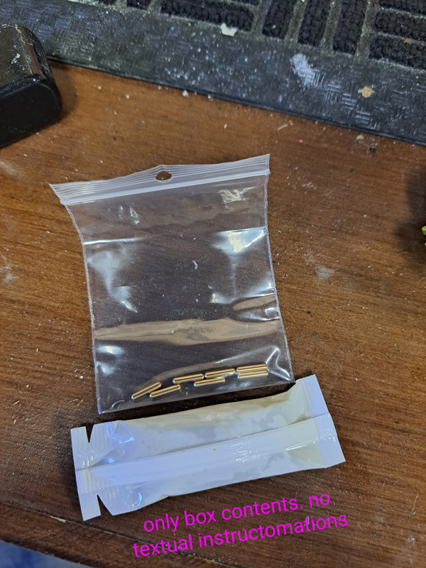

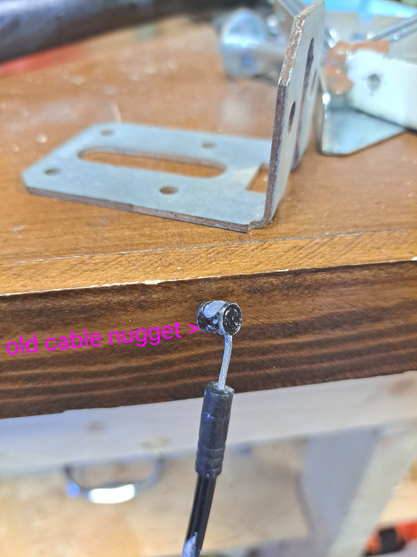

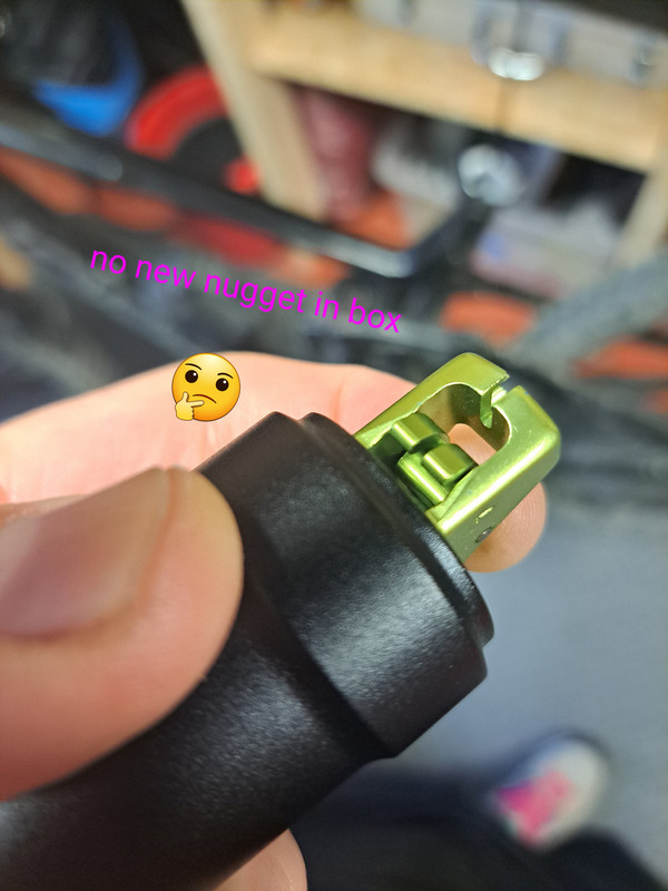

OneUp owners, some observations...
My post arrived and I was in such a hurry to fit it that I ignored a couple of things.
Firstly there was no cable stopper in the box to sit in the bottom of the post. It's unlikely that they're supposed to be sold without one but my current one fitted so I used that. Unfortunately that leaves my old post useless when it was destined for Facey Marketplace.
Then I realised that it's very unusual to have no paperwork at all in the box. No instruction manual, warranty info or anything.
I wonder if I received a post which had been opened and returned or something but I had it fitted so quickly I couldn't really query it.
The only fitting issue is that the recess for the cable stop in the bottom of the post is very shallow. It took a few attempts to get the post into position while yanking on the lever end without dislodging it and starting again.
Anyway, I'm happy. I got very lucky with the sizing as I didn't really measure up. It bottoms out in my bent seat tube then extends to perfect pedalling height. Any taller and I'd be opening it up to reduce the travel.
Posted : 20/08/2022 12:34 pm

I don't think mine came with the cable barrel or any instructions, so i think it's normal.

Posts: 462
I got a OneUp y for my wife's bike - it arrived today and came with a black nugget in the bag with the brass travel reducers. I've had really good customer service from them before so if it's not there, drop them a line and see. At least you'll get one to sell on with your post.
The V3 lever is really good too, with comfy rubber grip and reduced effort. It also comes with an inner, outer and nugget, which I didn't realise when I ordered. Which was nice.
