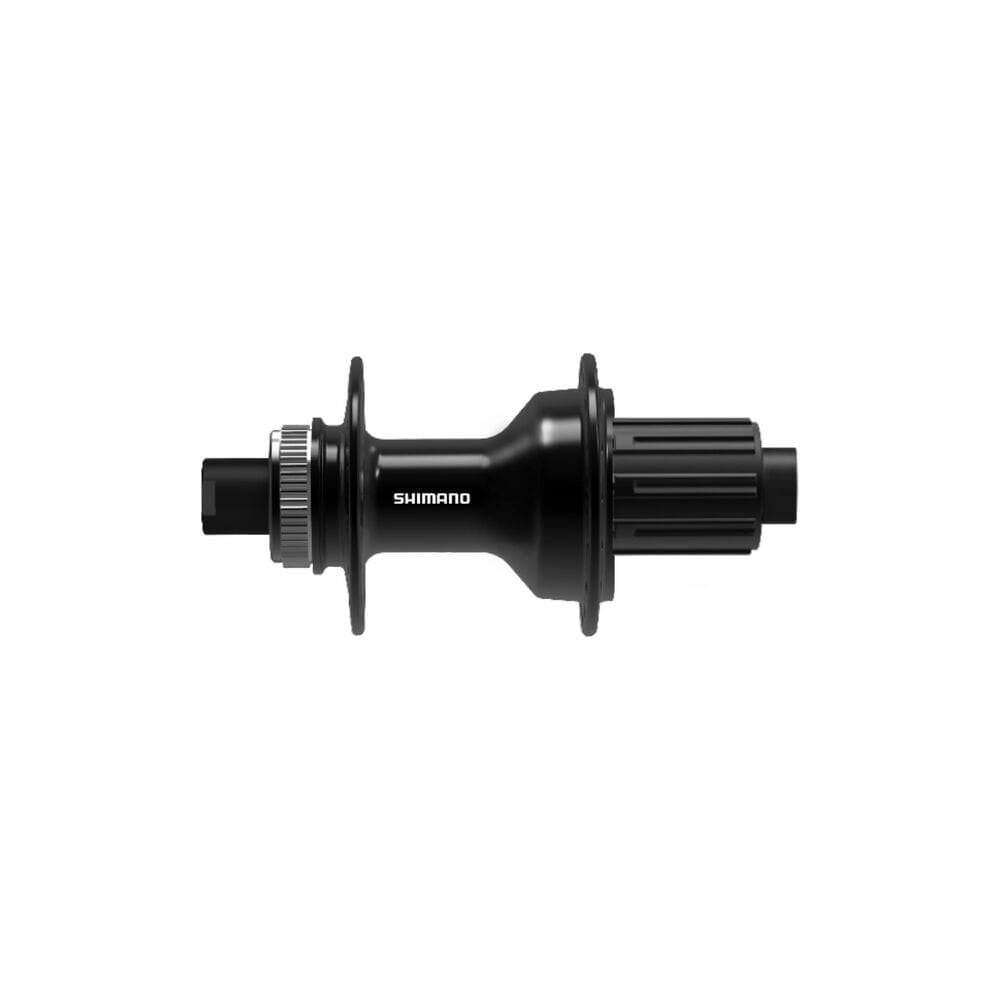

If you can live with centre lock (and a bit of extra beef) shimano also do some cartridge bearing hubs these days as part of the CUES rage:
this one is only £40 from sjs
https://www.sjscycles.co.uk/hubs-cassette-rear/shimano-cues-fhtc500hmb-centrelock-disc-rear-hub-black-12-x-148mm-32-hole/
for a few pounds more swinnerton have the slightly fancier version.
https://www.swinnertoncycles.co.uk/shimano-rear-hub-fh-tc600-hm-b-freehub-for-center-lock-mount-p119767
