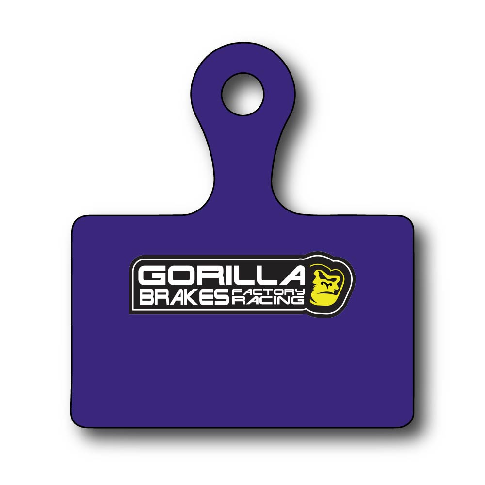

Looking at Gorilla Pads https://gorillabrakes.com/products/shimano-grx-disc-brake-pads-br-rx400-rx810-l03a-l02a?variant=45281315848511
But no idea on right compound? Any alternatives?

As for why Gorilla need 13 different compounds, who knows, even they don't seem to be sure.  "NRS" is apparently a different glue to the backing plate. Fine, but what does that mean for the compound, why does it have that weird spring, does that mean all their other pads will fall apart? Cynically I'd say it's so they can market them as being optimized in some way, £21 for "enduro pro ultimate" has to be good value right, it's only £5 more than enduro pro, which is a fiver more than the standard pad.....

I have Gorilla Enduro Pro Resin on my MTB, but have only done two rides on them so too soon to fully judge if they're worth the price.
