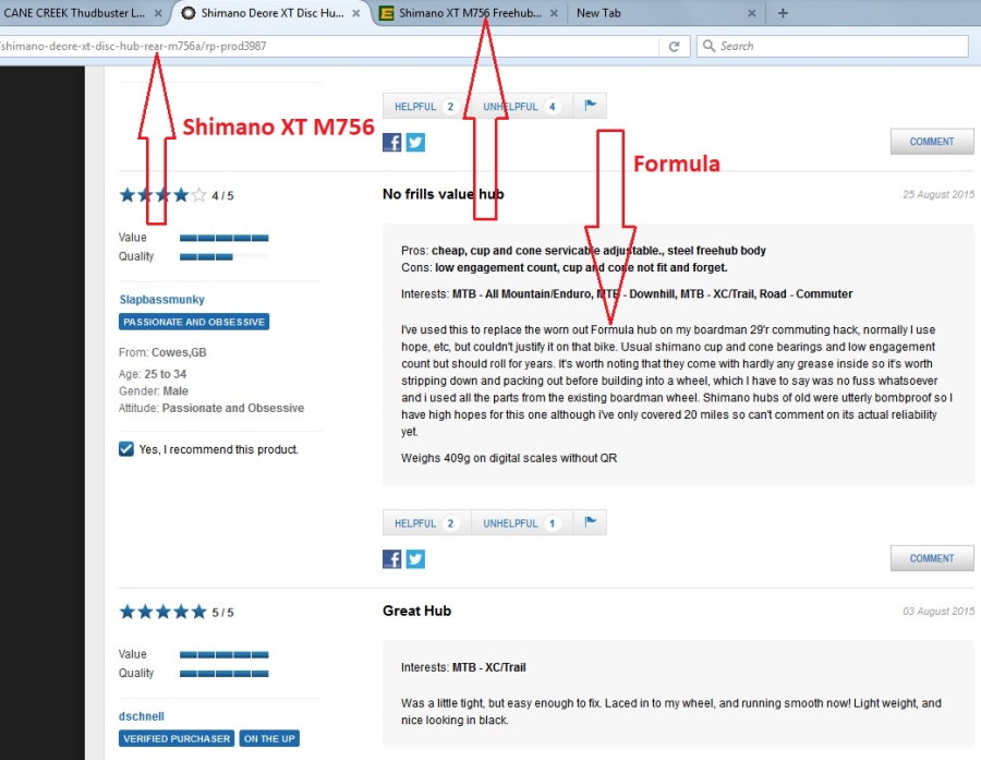

It reads like you’re intending to repair your existing hub, but if it’s any help to you - a few years ago I replaced the supposedly ‘Formula’ hub on a 2014 Boardman Pro 29er with a ‘Deore XT M756’ on the basis of the info in this screen-grab.
[url= https://i.postimg.cc/tCgdVZrB/XT-Hub-Boardman-Formula-900.jp g" target="_blank">https://i.postimg.cc/tCgdVZrB/XT-Hub-Boardman-Formula-900.jp g"/> [/img][/url]
Posted : 19/05/2020 8:32 am
