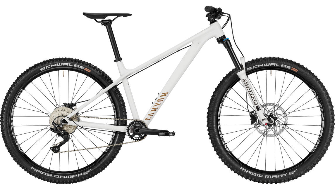

This is where my money would be going
https://www.canyon.com/en-gb/mountain-bikes/trail-bikes/stoic/stoic-2/2659.html?dwvar_2659_pv_rahmenfarbe=WH%2FMC&dwvar_2659_pv_rahmengroesse=L
£850, size large, in stock, add a dropper post for about £130 and you would have an amazing bike for the money (the reach on this in L is 480mm to give you an idea of 'modern')
£850, size large, in stock, add a dropper post for about £130 and you would have an amazing bike for the money (the reach on this in L is 480mm to give you an idea of ‘modern’)
Reach is a personal thing but in a hardtail at 6 feet I’d have thought this would be in the ballpark. I’m 5’9 with quite short arms / long legs for my height and I’ve just built a hardtail with a 445mm reach. My full suss bike is 457mm. I previously rode a bike with 481mm reach (full suspension) and found that a touch too long for me.
If the stoic is in stock then it would be a good plan to buy that and add a brand x ascend dropper post.

If you can stretch to the Stoic 2 I would go for that. For general trail riding I think it looks superb! Hannah STW did a review of a Stoic recently https://singletrackworld.com/wp-content/uploads/2020/12/canyon-stoic-4-140mm-of-hardtail-fun-reviewed/
The 2 has the exact same frame and I think wheels/tyres as this one... Ideal UK hardtail I would say

The Magic Mary/Hans Damph might be a bit overkill for the xc path type stuff. The tyres that come with the standard Bizango are Ardents only in tread pattern really, they're not tubeless ready and have the cheapest casing.
Posted : 14/12/2020 9:12 pm
Are these the tyres on the Canyon?
Posted : 14/12/2020 9:35 pm
Posts: 10361
Canyon has the proper tubeless off road mountain bike tyres. Really grippy - the front is a little slow rolling but pretty awesome.
