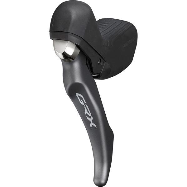

Anyone done this? It has occurred to me that I have a spare dropper which would fit nicely (girth and drop) into my gravel bike.
The bike has GRX kit, but unfortunately not the dropper lever version. I now run it single speed, so the gear shifters are redundant.
Is there an easy way to activate the dropper with the shifter? It would need to be a reversible hack I think.

Reversible might be the tricky bit, as you need to get rid of the indexing bits inside so it just pulls cable and releases

Video on it here, but "Dremel" and "cut" are the key words, I don't think you're coming back to a shifter afterwards.

I modified a 105 lever, by cutting the ratchet and removing the unneeded lever. It works fine, but the cable pull is quite low, so the cable tension adjustment had to be just right.

I've hacked up an old XT left hand shifter, as per YouTube videos, to operate my dropper. It works well.

Been pondering this with the new 1x12 GRX610 shifter.
I've only had a cursory look but on the 1x shifter, there is a cable entry slot and a cable guide towards the shifter mechanism. The brake lever is sprung in the "shifting" direction. The only thing stopping the lever swing is a nubbin on the lever limiting it's movement.
I'm wondering if cutting off that nubbin is all that's needed to make it a dropper lever.

I've still got the shifters spare but never committed to hacking them up. I'm running the 810 now with the built in dropper function
