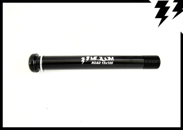

Posts: 6332
this is close in terms of length...124.4mm x 15mm
https://mtzoom.com/collections/thru-axles-and-skewers/products/road-front-thru-axle

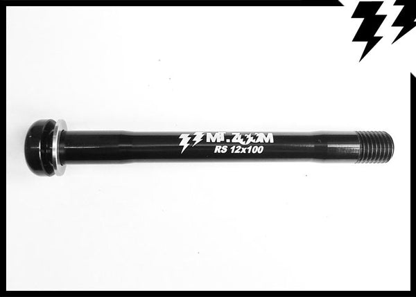

but yours suggest a 12mm diameter, so the narrowest MT Zoom do is 118.5mm in 12mm:
https://mtzoom.com/collections/thru-axles-and-skewers/products/e-thru-road-front-thru-axle
any good?
