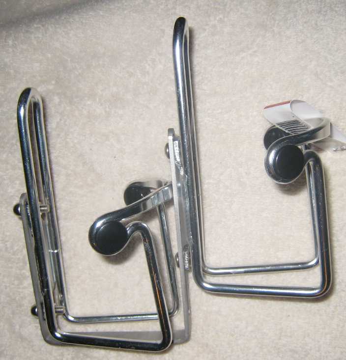

I have an On One inbred, which only has one set of water bottle bosses. I'd like to use two water bottle cages, but don't like the strap-on ones (they look awful and damage paintwork). So, what I am looking for is one of two things.
1) A double water bottle cage, something like this:
2) A double water bottle cage adapter, something like this:
I've managed to find anything on any UK or EU sites, anyone seen anything floating around?

You want to attatch 1.5kg that swings about to 0.6mm thick steel tubing?

Get some 5mm rivnuts off eBay and add another cage on the seat tube

I'm being slightly unhelpful above. I'm sorry.
But really. The tubing where bottle bosses are attatched is 0.6mm thick. And the way those bottle cages are mounted, the potential for tearing the bosses from the tube is high.
Rivnuts in seat tube is ideal. Though you won't be able to drop a long seatpost down.
Posted : 16/08/2014 5:44 pm
Posts: 7567
This makes me less scared.
http://www.parkersofbolton.co.uk/p-3725-m-wave-bike-double-bottle-cage-adapter.aspx

Cheers all, sorry for the slow response.
To be honest, it was a bit of a 'that would be rather useful' thought pattern, without really thinking it through. Not really like me.
brant, thank you. Having someone who designs the frames tell me it's a bad idea is pretty convincing 😀
I might look into Rivnuts, but will probably wait until I get the frame resprayed in the next couple of months and do it at the same time.

I've jubilee clipped another cage to the seat tube. Not pretty but v solid. If you are worried about the paint, put some plastic shims underneath each clip.

[url= http://www.amazon.co.uk/Minoura-Bottle-Cage-Adapter-Saddle-aluminum-Colour/dp/B001B13J1E ]Buy it here[/url]

Looks like this is exactly what you wanted
