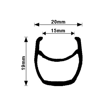

Posts: 125
fair enough-the OP was about [i]road[/i] use
images below show open pro width as15mm & schwalbe tyre rim width/tyre size recommended -chart
I think possible and optimal are two different ideas
I found the larger sizes on the smaller rim to be too 'light bulb' in cross section for me
[img] http://blog.fairwheelbikes.com/reviews-and-testing/alloy-rim-roundup/mavic-open-pro/ [/img][img] http://road.cc/content/feature/213558-what-width-tyres-are-best-you-youve-never-had-wider-choice-high-performance [/img]
