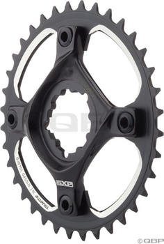

I've seen a few threads on Truvativ x9 2x10 to 1x10 conversion. My limited understanding - being a bit of a technical numpty - is that the 2x10 crankset has a detachable spider, and so it's a simple job to replace the spider/chainrings with a single spiderless ring, or one of these -
Does this also apply to the 3x10, or is it more complicated than that?

3x10 works just the same but be aware that x9/x0 spiders are slightly different (an MRP Bling ring will fit fine on either).
If youve got a 3x10 crank then a cheaper option might be to ditch the stock rings and run any non-ramped (hope/renthal etc) chainring in the middle position as they are standard 104bcd.

So all I need to do is replace the spider/chainrings with one of these -
And then of course get a chain-guide of some shape or form? Any reccomendations for a chain-guide?
