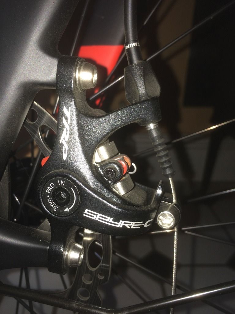

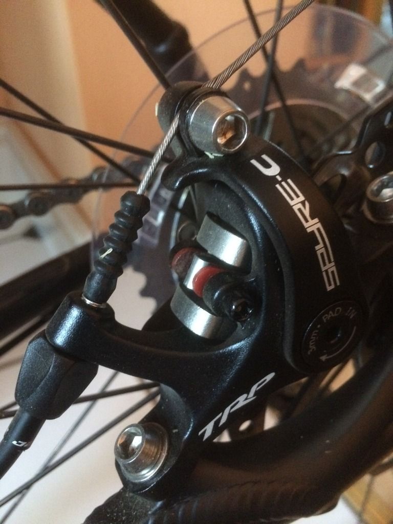

Just to double check, these are wrong, aren't they? (Thank you LBS!)
(The bike is only a week old - The brakes seem to be powerful enough, but need a good squeeze compared to hydraulics (Tiagra 4700 levers). They feel a bit wooden, but I'm sure they're still bedding in as I've only done ~100 miles on it so far.)
[edit: Sorry for the hijack! 😳 ]
Yes, that's wrong*
Just look where the serrated 'cable grip' part is on the small plate under the pinch bolt...
Changing it gives a slight increase in leverage and helps. Not hugely, but it does. They feel rather wooden until you change it.
*Although not necessarily LBSs fault as such....

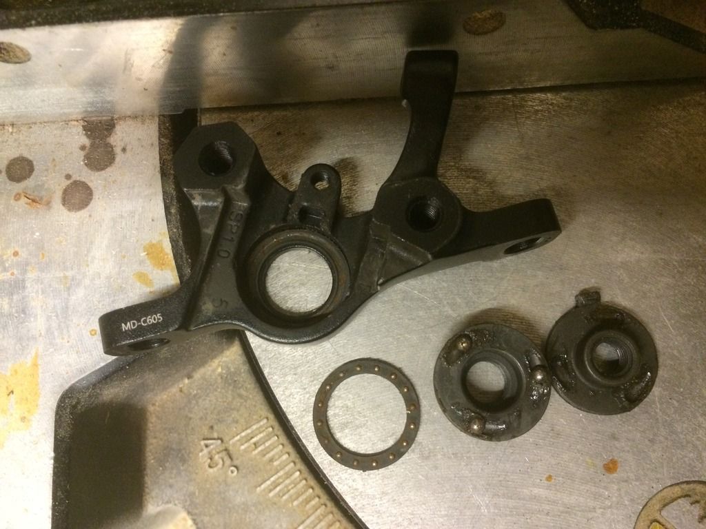

A couple more pieces of the jigsaw:
I took some of the slack out of the cable (to reduce lever travel) and realised that the brakes lost power again! - My bike has the current Tiagra combined brake/shift levers which apparently have a variable pull rate. The brakes work noticeably better with more lever travel (bite point with the lever at a guestimated 50% of the way back to the bars - compared to about 20% that appears 'correct and workmanlike' to me). This needs a lot of slack in the cable, since the brakes seem to bite best with the pads set up quite close.
The other, more annoying, thing is that I noticed the movement of the arm on the front caliper started to feel rough and 'gritty'.
Thanks to the very helpful [url= http://singletrackworld.com/forum/topic/psa-trp-spyre-rebuild-guide ]rebuild guide[/url] I stripped it down and found that, as predicted by spangelsaregreat, the thrust bearing between the rotating part of the 'piston' and the caliper housing was dry and starting to go rusty. The bike is just over 3 weeks old!
(The outer race is still in the caliper housing in the photo, but it just lifts out.)
I cleaned everything up and gave it a thin smear of waterproof grease, and it's operating smoothly again.
I don't know how long it will last - I hate to think what will happen with Autumn / Winter commuting 🙁
I need to do the same to the rear caliper now as a preventative measure, but might get hold of some pukka brake grease so I can leave a bit more in there without worrying about it melting out.
I've probably invalidated the warranty on the brakes by doing this (they're not supposed to be serviceable), but I can't see the point of waiting for them to sieze up, then arguing to get them replaced with another set that will do the same. It wouldn't have been difficult to add some seals to the design to make it bomb-proof.
