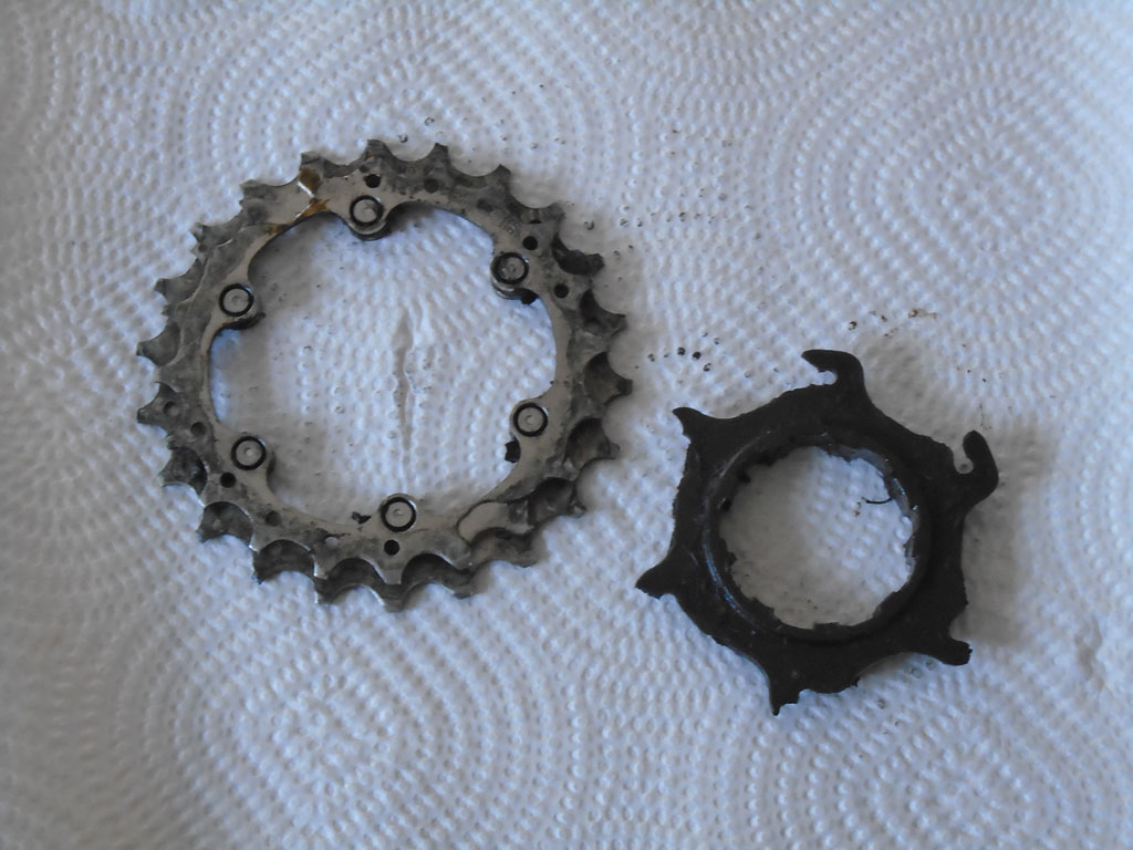

this is a new one o...
this is a new one on me
[#12724772]
more ultegra cheese or putting out more power than MvP 😉
plastic spiders! it was an interesting ride home I even had to use the inner ring.

fake ultegra? was it bought from a reputable source?

According to this review<i>R8000 has the 19T and 21T steel sprockets mounted together, on a carbon fibre spider. </i>Surprised me too.
Isn't that the inner ring that's fallen off?!
Posted : 15/02/2023 12:46 pm
Posts: 39916
Isn’t that the inner ring that’s fallen off?!
its a cassette ?

What you been cleaning it with?
Three ways i've seen those go is a) people with no mechanical sympathy (full power up and down shits all the time), b) cleaning the cassette with aggressive degreasers and C) the dodgy Dura Ace rivets, which should have LONG since gone, they stopped that design more than 5 years ago.
They've had the carbon spiders now for 2(?) generations, so it's not a new design
Posted : 15/02/2023 12:52 pm
n0t 8000 it's a cs 6800.
i only clean with soapy water and a brush.
