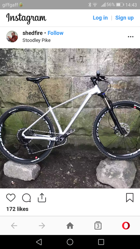

Brant has commented on a couple of recent threads about the new Scandal coming shortly and it being priced around £150 to £200.
I'm holding out for a new Scandal to replace my cube frame. I am one of the many people who regretted selling a Scandal and wants a new one, preferably XL and in raw.
So, I thought I'd start a new thread so Brant can update us. If there isn't an available date in the near future can anyone recommend anything else to consider? Frame only option. Thanks
[url= https://i.postimg.cc/PrJK2G8y/Screenshot-20190316-144327.pn g" target="_blank">https://i.postimg.cc/PrJK2G8y/Screenshot-20190316-144327.pn g"/> [/img][/url]
To keep us going, post pictures of scandals here.
