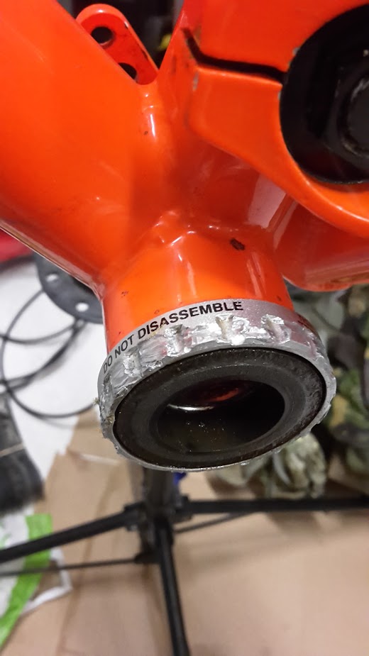

Bought a second hand frame, and the BB is shot so went to swap it out. Non drive side was very stiff but came out eventually, drive side is utterly utterly stuck.
I am turning it the correct way as indicated by it being written on the cups, I've soaked it in wd40 overnight, tried pouring boiling water over it, battered the tool with a hammer and latterly clamped the tool in a vice and tried turning the frame.
So far I've managed to munge up the indentations and that's it. Any ideas? If i have to take a hacksaw to it, whats the best approach?

If you hacksaw off the external cup, the rest of it will be impossible to get out.
Can you clamp the cup itself rather than the tool in the vice and turn the frame (in either direction) - tightening it might actually help get it moving.

Get a pipe wrench on it.
Also try something better than WD40, I've used Plus Gas penetratiing oil which seems to do the trick.

What MH said ..but with more hot water, maybe wrap a cloth round it to keep the heat on the frame and not just poring off.
No idea why some ppl think it's necessary to screw on the BB so tightly.

Plus Gas. Pipe Wrench. Oh. And maybe a bolt and stuff and a big washer kind of thing to hold the pipe wrench on.

If you get really desperate then you could probably bash the internals out from the other side then very (very) carefully cut some slots from the inside to the BB shell in line with the BB axle direction. Very slow and very risky as if you go to far there is a good chance of destroying threads.
I'd do what Brant said first. Also I hear good things about coca cola but have no experience of using it myself.

If there's enough left, what you really wanted was a bb socket on a breaker bar...

I've used some sort of homemade fix with a lot of bolts and washers to hold the tools firmly on the BB then apply the force of 3 good men....

Some kind of penetrating / release oil (not wd40 or gt85) might help here. That's what I used last time I had a tough bottom bracket to get out. Spray it liberally the night before you plan to get it out. Then spray it again in the morning a few hours before having a go at it. Leverage is probably your friend - I connected all the bars in my socket set so I had a bout a 3 foot long bar attached to the bb tool. Your main problem is making sure the tool doesn't twist off the bb - especially if you've managed the cup already. Maybe have a friend to push the tool on the bb whilst you heave on the bar.

If you saw the cup off you can cut through the remainder of the bb which will easily collapse and come out.
You're likely to cut into the threads but if you it carefully and at a position where they are well reinforced (by another tube or weld) it will be fine.

Plus Gas (lots of), tap BB shell with plastic mallet, BB tool in vice, hot water on BB shell and repeat in various order.
Posted : 06/11/2016 8:10 pm
Posts: 1617
Steel frame an aluminium cup so CTE of cup is greater so you would want to flash cool the cup to it retracts away.
I would cut a slot through the outside bit and then carefully cut through the inner bit of the threads until you are just through to the teeth. Do this at two positions opposite each other.
Then squeeze in a vice to deform and break the remaining bits of metal and undo.

Well here we are a few days later. I got some proper penetrating oil, left it in it for a few days whilst I waited for a socket to arrive.
Got some heat into it with boiling water
Put the socket on and gave it a healthy few smacks
Breaker bar.. nope. Ok, socket has flats on it to grip it, so in the vice it goes
turn the frame.. no wait, thats the vice turning...
secure vice more.. same again
secure vice more.. workbench tries to turn
secure workbench more.. indentations get more munged up
It's now beyond my help. Where to take it in Bristol?

Has previous user welded it in.
No joke, have spent an afternoon trying to get a bottom bracket out of a customers bike, only to find the previous owner (allegedly) had put a few blobs of weld to hold it in place as the threads were beyond repair.
They certainly were beyond repair by the time we'd got the bottom bracket out.

Plus gas. Overnight. More plus gas.
I bolted the tool to the cup using the old BB.
I then stood on on chainstay, with bike upright on old cloths.
Two small_oabs then added a 6' (yes that is feet) scaffold pole to the ratchet handle by sliding over the top.
They then used the garden wall to balance while walking along the 6' pole.
As they neared the end, there was a lovely little sigh from the bb and it released.
The threads were perfect - just immobilised in there.

If it's a steel frame then get some caustic soda in there and see it melt away before your very eyes. Just keep your eyes well out of the way.

Chorlton is right about Steel+Aluminium+Caustic Soda.
Worked for me, Homebase £2 and a old washing basin and job's a goodun.
Mine needed two dips and one tub lasts about three goes.

A friend's road bike had the same issue.
We used the vice technique. Because the bottom bracket kept slipping, we REALLY tightened the vice, to the point the bottom bracket started to deform. That gave the bottom bracket a 'flat' face and meant it didn't slip in the vice.
It eventually worked. We had to check more than once that we were turning the frame the right way.

are you sure you are turning that anti clockwise? The slipping damage looks like you are turning it the wrong way.
A quick rule with BB's is if the bearings jam it will undo with normal pedalling and jam on the crank arms. This saves it being tightened into the frame if the bearings jam.
Pedal threads are the opposite and will tighten if the pedal bearings fail as having a pedal unscrew can cause an accident.

don't forget if you have the bb clamped in a vice to turn the frame the opposite direction to the arrow on the cup....
I think OP's doing it right, unless it's "Italian" BB. "English" threading is left-hand thread for the drive-side, isn't it ?
Posted : 11/11/2016 12:04 am
Both side towards the front of the upright bike to undo. I agree that the marks look like it's slipping clockwise assuming that the bike in the picture is upright and non drive side.

Absolutely doing it the right way..
So all booked in at a LBS to fix.. right. But wait.. surely this cant be beyond my powers.. surely. Especially after that extra penetrating oil applied yesterday...
Well go on then, one more go.
Socket on. Hammer applied for shock force
Socket in the vice, frame for leverage
Damn it's shredding the ... no wait! it's turning, oh my god its actually turning!
A few quarter turns using the frame for leverage and ... clunk... aha that'll be what everyone said about it unseizing!
