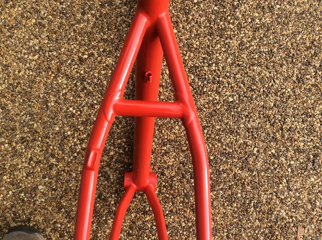

Photos later of todays 'plaster' repairs and I am not talking about my thumb I shoved the hacksaw through..............:)
I am happy anyway..........
Posted : 13/02/2021 4:38 pm
So, before I start anything here, special thanks to Mick , who has gone beyond to help me with getting the bike back together again. I had a delivery this morning of a well packed and 'Mick Kit' tm , as it will be known of tubing , fluxes and welding rods. What I havent used, will be heading back to Mick for when we arrange a replacement chainstay to be fitted in the summer, geared bike months.
So, probably wrong to do, but the crack seemed to be at an angle, so I used a dremel to remove it. I also drilled a 1mm hole at the crack ends to prevent growth. I cleaned, cleaned and cleaned again, the frame , as thats the most important thing.
I then had a brand new mapp/oxygen welder from work, which was totally useless as the oxygen wouldnt stop hissing big time out the bottle to valve and when I removed the regulator the bottle kept hissing. So, binned that. I was ready to do this and all had was a mapp torch. So, out it came. I brazed up the slot in the frame really easily , even if it was minus something outside, as wanted to not damage my plastic floor in the garage with any flux and weld slag.
By the time I had filed and emery cleaned it was the same height as the frame chainstay.
Now, in this Mick Kit tm , was a selection of frame off cut tubing. More differing versions than chocolates in a box of Milk Tray. So, what to pick ? There was a piece of chainstay there and that was the chosen piece. I cut it in half and thats where the claret then smothered my dna everywhere as a hacksaw makes lighter work of thumbs than chromoly tubes. With the shape of the tubing, I 'overlatched' the underside ( if it was upright) and then bent and hammered to the contours of the chainstay. Mick had given me lots of materials, but with the brass rod making life easy, i decided to braze again with brass rather than silver.
Generally it has gone better than I was expecting . I have obviously cleaned up the plate with emery cloth and a wired wheel on a drill. I need to do a bit more tidying before I mask most of the frame and get some primer , top coat and lacquer to hopefully finish off.
This is temporary as long term I will get a new chainstay fitted and the frame and forks refinished. As Andy at Stooge says, only 100 of these were made , so worth keeping it as I do enjoy riding it.

If people are interested then let me know, i'll keep updating to the first ride ?. This morning I gave it 3 coats of rattle can primer. As the garage is a massive 4 deg , I kept the frame and paint in the house overnight. Bit more prep and clean then masked up. Wasnt planning on sharp edges, more feathering near the tape, but being so cold,the paint wasnt going to have that. So, I will have some wet flatting to do . But looking great. In fact the grey works well with the Stooge blue.
The house now stinks of paint and the garage doesnt. Weird that and currently not very popular.
Posted : 14/02/2021 11:49 am

And ... looking back at the last picture of the chainstays before priming, looks like a crack in the opposite chainstay! 😳
Posted : 14/02/2021 1:24 pm
 sv
Posts: 2816
Think that's the edge of the clear protection tape and not a crack! Mk1s are lovely.
Posted : 14/02/2021 2:15 pm
Much to the eagle eyes finding additional cracks, that is frame protector. Phew......
So, without any drum rolls, its painted.......
Wrong colour mind but the local paintshop and me spent hours last summer trying to match. Its slightly darker but I am happy as it has a future. 2 coats of colour and a coat of lacquer. Its not gloss or matt but a satin, which I didnt have so it is now matt, but polishable.
Let it dry before rebuild........
