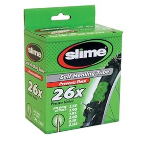

Some sealants do work in tubes. I use these and have had no punctures for a year. Maybe the sealant in these is thicker (possibly heavier) than the Stans stuff?
Tube sealant (Slime et al) are all much much thicker than tubeless sealants, which tend to be a similar consistency to water. I imagine that's why they're not really cross compatible, what MSP said makes sense.
