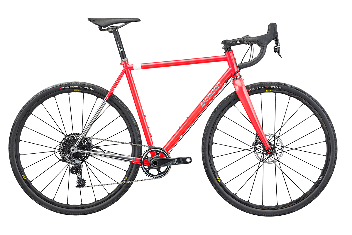

Standert Erdgeschoss .... when it's actually possible to buy one again. Last batch sold out in hours. Some good details and reasonable price. 650b builds though as er standard, which may or may not suit.

That standert looks outstanding and reasonably priced too.

Posts: 901
Aye. Any brand that can slide references to golden-age hip hop legends into their colour options is onto a winner for sure...but other big hitting deets are the T47 BB, King headset included, neat internal routing, on-the-numbers geo, multi frame zits...The spec of the stainless tubing may not be as chi-chi as 953 or XCR but at the pricepoint its hard to beat. I'm sure those natty Berliners could order up a container load ten times bigger next time around and they'd still sell out fast...
