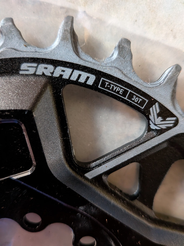

T-Type rings (Sram originals anyway) have this:
Posted by: Alex
SRAM. Why, just why!
Yup, went through this when I bought my son a nice T-type crank and none of his Sram drivetrain worked with it!
Posted : 16/07/2026 10:27 am
Alex reacted

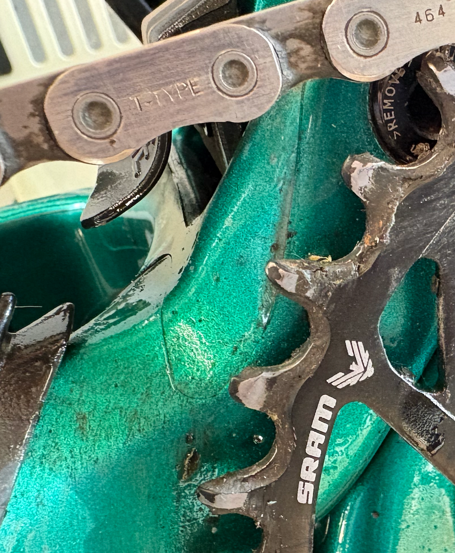

 Alex
Posts: 7863
So my chain ring does NOT say T-Type where as the chain/cassette and mech do. Got to be worth a go and seems like @desperatebicycle had the same experience.

Posts: 7718
Yep, the Moterra's non-t-type chainring was running a t-type chain and now isn't and works fine. Must've been the other way around with my son's - the t-type chainring didn't like a normal chain and jumped about a bit.
