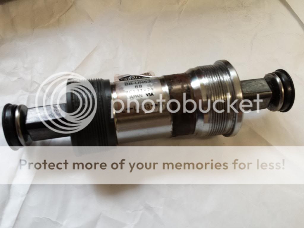

also have a square taper b/b (shimano UN-53 for a 68mm shell with a 113mm axle width)in good condition and still spins smoothly
£15 + postage for both of them
