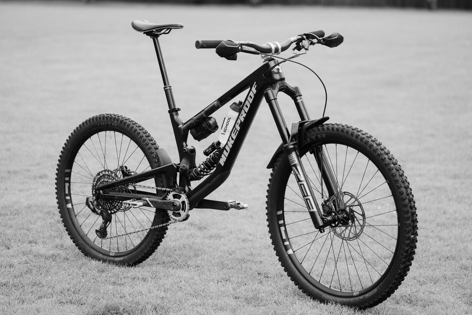

Whilst you're experimenting with your suspension, how about trying out a pro enduro riders setup 🤟😉
https://tweedvalleybikes.co.uk/blogs/news/innes-graham-nukeproof-giga-297-bike-check#:~:text=Onto%20the%20suspension%2C%20Innes%20runs,to%20follow%20the%20trail%20contours.
