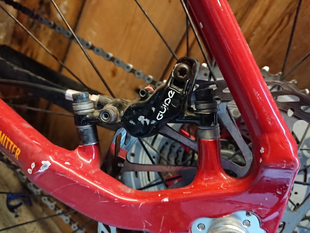

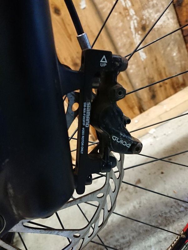

I took some pictures of our Medium Transmitter 180 on rear with Avid post mount spacers (one is longer than other) and front Shimano 203 adapter.
rear Transmitter 180 disc
front Transmitter 203 disc

I did exactly the same, 203 on the front, shift the 180 to the back. It was tight getting the caliper on the new mount inside the rear triangle, but it did fit. Mines got the Sram Level calipers, maybe the Guide RS is a larger caliper.
Edit: my phones just loaded the pics above - doesn't look like that's the problem.
