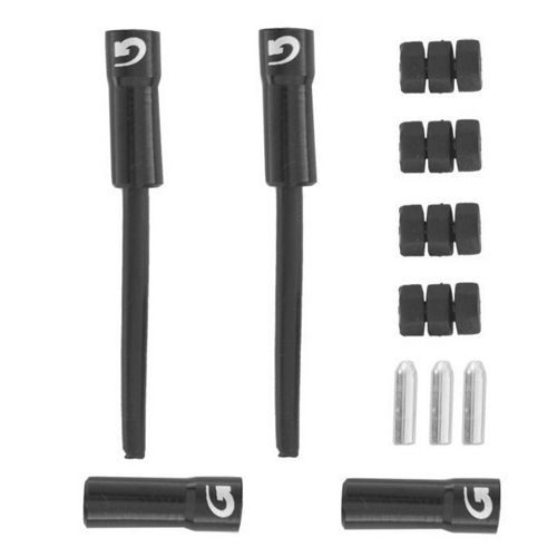

Where are those from scaredypants? I am loathed to buy another mech without being 100% sure it's going to fit. And I can't figure out from images on the net if the top swing mechs are much closer to the centre line

Scaredy pants long ended ferrules just get eaten through by the cable really quickly...
