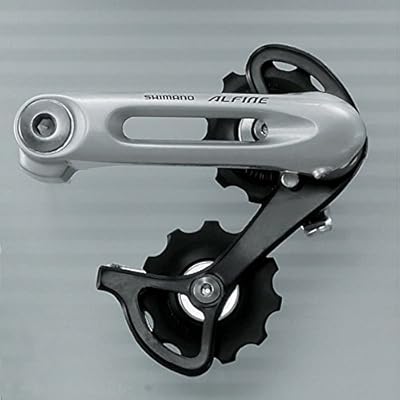

I'd imagine if you need to accommodate some chain grow a double pulley tensioner like this alfine CT-S500 is a good option:
But it's not much cheaper than a Deore or slx mech...
