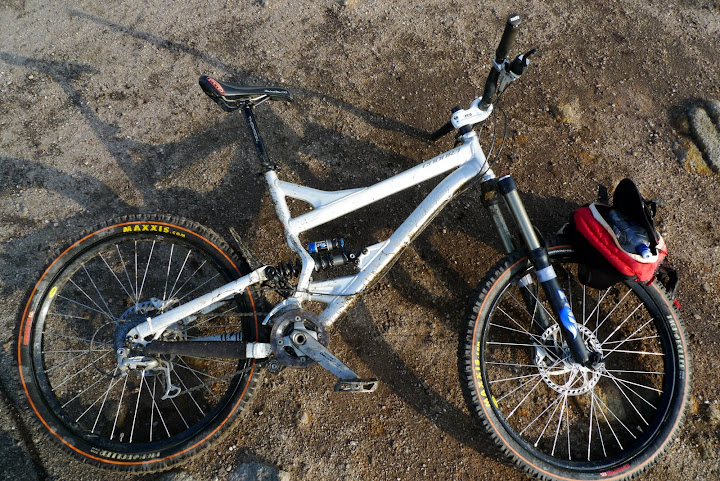

My 2006 S-Works with Fox 36r's, Fox DHX 5 coil rear shock, Chris king rear hub, Superstar front hub, Mavic 729 rims and whopping big rotors its built for shagging downhill and isn't light at 38lbs. Slack shuttle in too making the head angle super slack. 🙂
