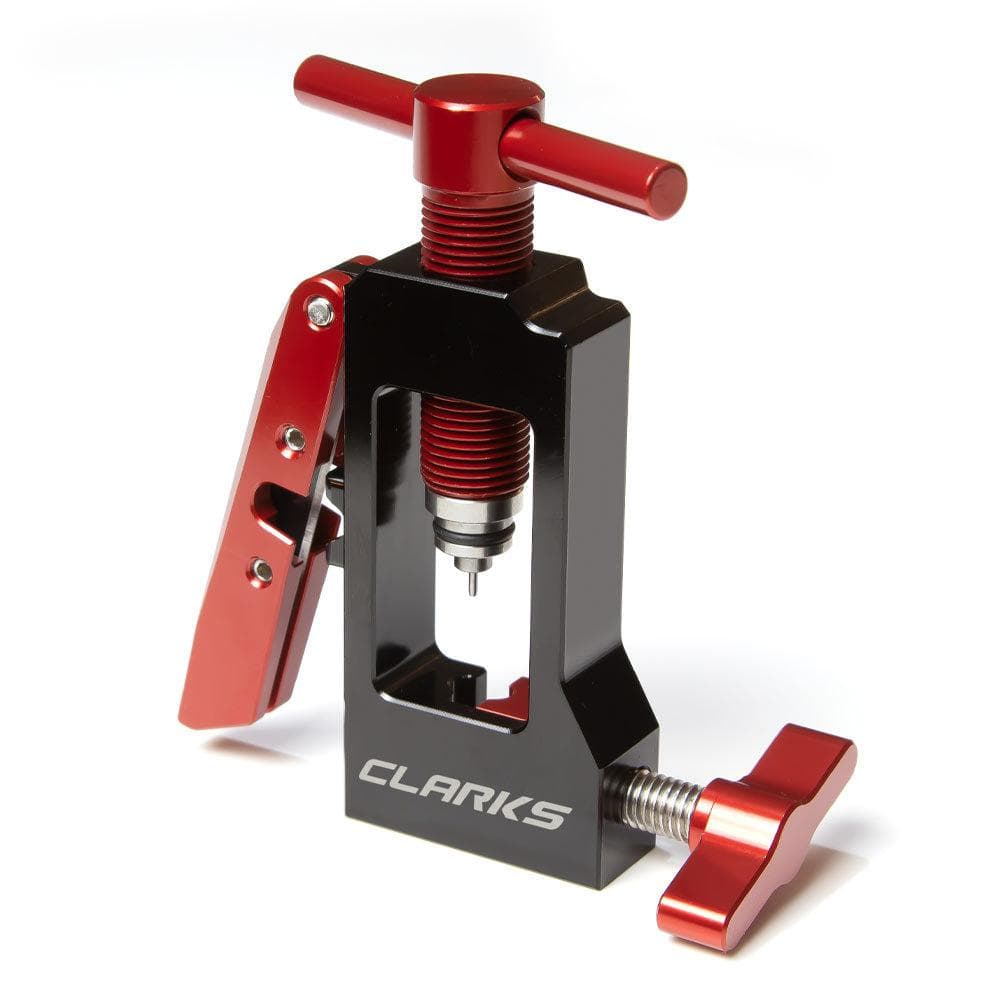

First time using shimano brake hardware, will possibly need to shorten hoses at some point. Do I need this specific tool? If so are there any (much) cheaper alternatives to look at?

Thanks all, StuE that looks just the job, (I’ve also just seen a jagwire version) I’ll get one ordered. Ta

The Jagwire insert tool "thingy" is an absolute must. I bought one recently having borrowed a friends and its a tool that instantly made we query "why don't I already have one of these"!
A proper hose cutter is worth it too.
I've got one of these:
https://epicbleedsolutions.com/products/hydraulic-brake-hose-cutter
Wrestling with those yellow blocks is a horrible task especially if you are trying to get away without bleeding.

The Jagwire cutter is excellent, a slicing action with a clean finish. The Jagwire tool for inserting, well inserts, is also excellent. There are other methods which can be used but if you’re trying to shorten a hose, replace a calliper or lever then these tools allow the minimum disturbance and often bleed free alterations. They are reasonably cheap, they work, they make life easier!
