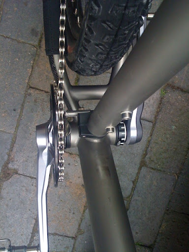

"Blackspire DH, so no shifting ramps etc."
It depends on the riding and how well the unramped chainring holds the chain as to whether you need any sort of chain device.
I ran a thorn unramped chainring (from SJS, twas cheapish - I know at least one of the S/S on-one ones work too), without anythign for quite a while without a problem. General XC and anything upto the 'lumpiness' of sherwood pines caused no problems whatsoever.
When I started to try it on steps/stairs and more rooty/rocky stuff it did start to fall off a few times a ride
I've now got a plastic FSA bashguard (I think they're £14 from CRC (inc. longer chainring bolts - the 32T one is big enough to guide a 34T ring too) and one of those mounts for a 'classic' zefal style pumps (just pointing toward the chainring where the chain is, it phyically stops the chain from coming off. An N-gear jump stop as mentioned above would do a better job, but it costs and weighs more, I can't seem to find them that readily available and I had the pump bracket lying around already
I'll get some pics up if you want
