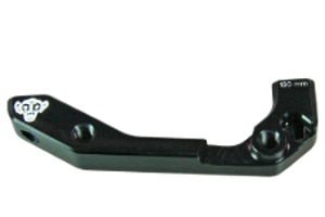

You'll need a Monkeybone.

I've got one of those on my Peregrine but I thought it only fitted IS seat stay disc mounts?
Posted : 13/04/2015 9:49 pm
Posts: 17783
It'll fit anything with IS mounts. Doesn't matter if they're seat or chainstay mounted.
If it's post mount I can't see how you can avoid using the torque arm.

Only IS is correct (i.e. not post mount), but it can be on the seat or chain stays, see
[url= http://singletrackworld.com/forum/topic/for-the-friends-of-unusual-rohloff-cable-routing ]Rohloff cable routing[/url]
albeit this is with the on-one slot dropouts using a Monkey Bone.

Right, that sounds like a possibility then, Jones Plus is IS mount, not post. Thanks for the info guys.
