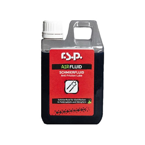

Posts: 34823
RSP Air fluid
Is available from tftuned and others for rockshox lowers
https://j-techsuspension.co.uk/products/rsp-air-fluid
