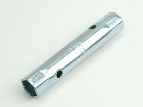

there is a slight chamfer on the inside edge
Yeah, thought that might be an issue (but optimistically disregarded it!).
If you can't grind it down get hold of a box spanner - I don't think I've ever seen one of those with a chamfer. They bear on the points but unless it's completely borked I'd hope you'd be OK.
Posted : 27/10/2011 9:21 am
nice idea on the box spanner! i'll see if i can get a 24mm one
