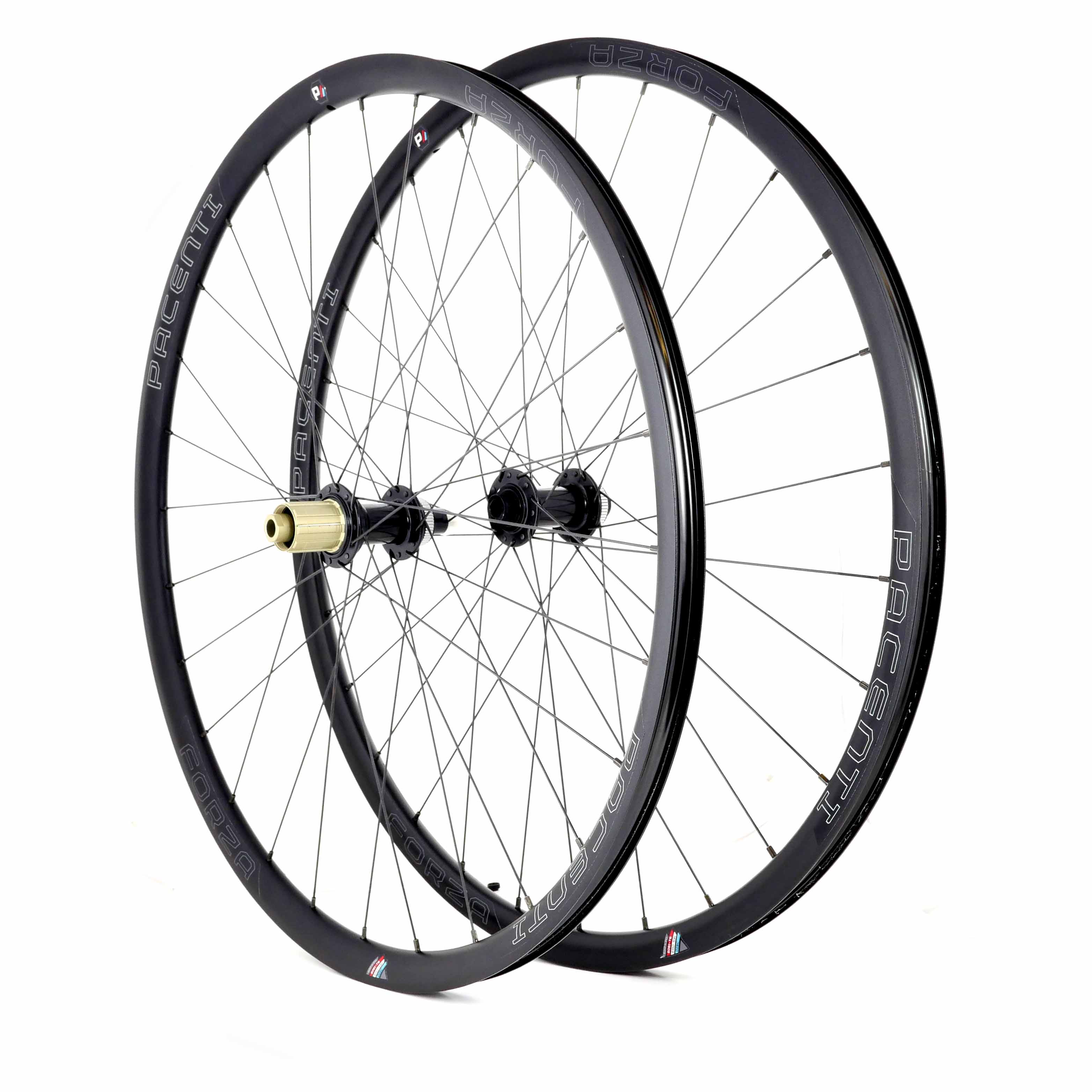

Check out Pacenti, their hubs are Bitex, so the same as Scribe (and probably also Hunt/Prime) but I *think* the rims are very slightly nicer (assuming Scribe/Hunt etc. use Kinlin rims, the Pacentis are a tiny bit lighter/nicer finished).
I'm a bit of a fan boy but have a horrible feeling it's mostly down to the Italian sounding name and fancy stickers...
https://pacenticycledesign.co.uk/collections/aluminium-wheels-road/products/forza-wheelset-centre-lock-disc-brake-700c
Edit: new ones don't have quite as fancy stickers it seems...
Posted : 23/02/2021 6:08 pm

I’ve got Pacenti rims on the gravel bike, but they have required a bit of attention to keep them straight, but I guess that could be the build. That Pacenti set are giving away 200grams though to the Scribe/Prime.
