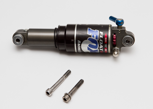

Have had a clicking noise / stiction from my rear shock for a while.
Shock was serviced by Mojo with new DU bushings etc at the end of 09 and it's not had a lot of use since.
Replaced frame bearings last month to no avail so I had the shock out last night to measure for new DU bushings.
The 'seat stay' pivot bolt on the left below has a distinct bend in it so where can I get a replacement?
Frame is an 01/02 S Works FSR so I doubt Spesh will want to know.
Bolt is 51.5mm long, 6mm OD and 5mm hex head.
Muchos Gracias

Any normal bolt supplier will probably be able to sort one for you, if not try Mojo or TF Tuned.

You may also want to check your air pressure, bent pivot bolts are often the result of the shock bottoming out.

I have some spare bolts I can give you a couple, just send me over a message!
Ahh interesting point and thanks for mentioning it. 🙂
Kaesae
Cheers for the offer. I'm going to take a punt with a Ti bolt from www.pro-bolt.com though they only have tapered cap heads.
If that doesn't work out I'll drop you a line.
