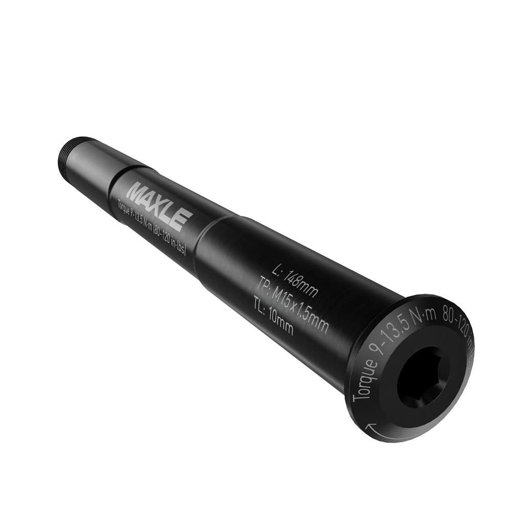

Interesting, is it one of these style ones ?
https://www.swinnertoncycles.co.uk/rock-shox-skewer-axle-maxle-stealth-front-12x100-length-134mm-thread-length-9mm-thread-pitch-m12x1-50-rudy-p107480
I have always undone it from the bolt end with the smaller dia hex tool, as I thought that the larger end would undo the cup ? (and it turn tighten the bolt while undoing cup.. ?)  I do think I once did a 1/4 turn of undo on that larger cup end before realising I was at the wrong side, but no apparent harm done to any threads.

One of these
https://www.giantbikespares.com/Giant-Road-Bike-Front-Thru-Axle-%28with-removable-hex-lever%29--300000109_1519-QRGA19-0003/product_detail/3-46922
Just a simple threaded axle. The hex socket on the threaded end is recessed and looks like a circular recess/ end of a tube which is why I discounted it.
Swapped wheels over just now using a longer hex key.
