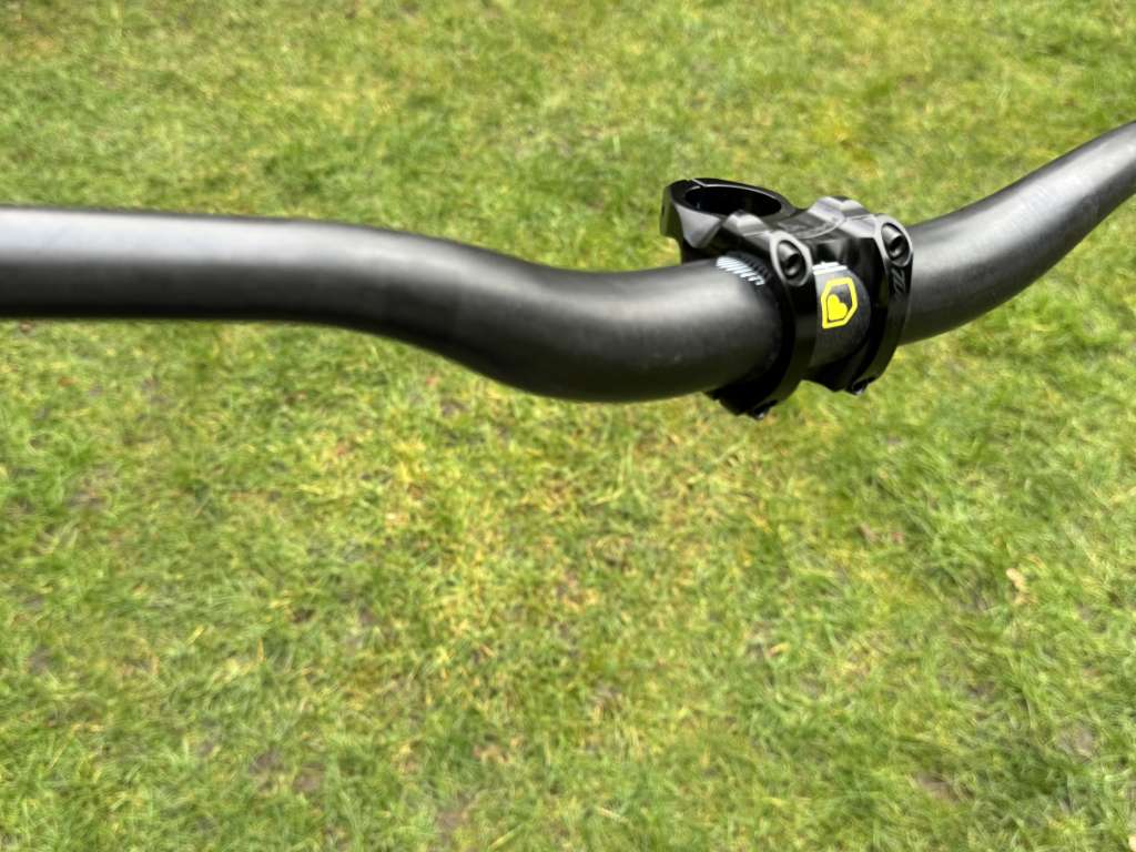

Posts: 677
Luckily there are markings under the grips so I’ve tried a little wet sanding there and it has done a good job.
I think I can take it all off that way and then give the whole thing a polish to get the finish consistent again without going all the way through the existing finish.

Posts: 677
It went really well! I wet sanded with 1200, 2000 and 5000 grit paper making sure to do the entire bar except the clamping area. After that I went over it with plain car paintwork polish on a felt drill pad thing.
I’d say it is an ever so slightly lighter shade of dark grey now I’m finished and much more subtle with just the little burgtec heart in the centre.

Posts: 14042
Nice job, much better than original
