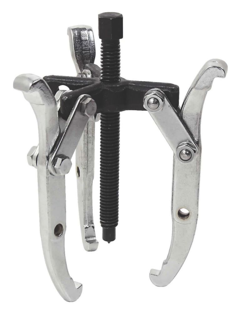

Gear Puller.
[img] https://media.screwfix.com/is/image//ae235?src=ae235/12510_P&$prodImageMedium$ [/img]
Posted : 18/12/2019 11:19 am

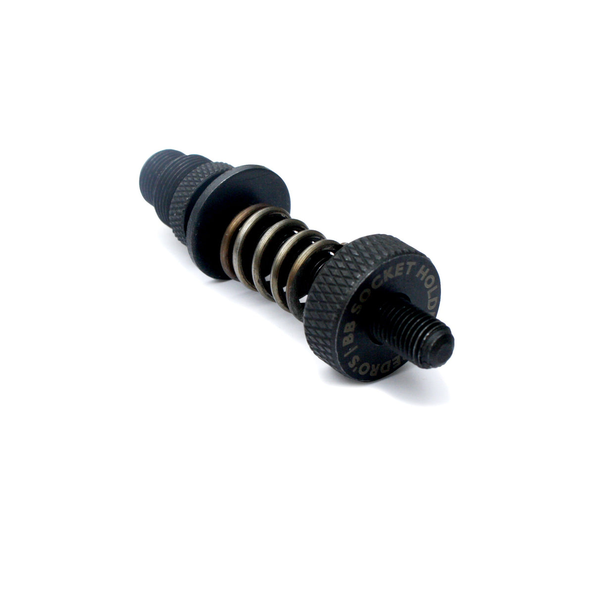

You also want a socket holder and a breaker bar (I use a Trailgator - only thing it is good for)
https://pedros.com/products/tools/pedal-crank-and-bottom-bracket/bb-socket-holder/
